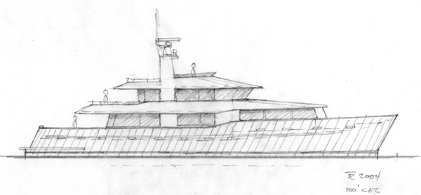

  10. TRY
    TRY Senior Member
    Sep 6, 2004
    269
    cannes
    an online concept
    Lars has shown his way, he's a designer and a very good one!
    This is how I start a concept, I'm not a designer, see the difference?
    Challenge to our on-forum design gurus: turn these boxes into a yacht, online, in view of all.
    Interactivity is welcomed from the 1000+ members.
    Interesting experience, no?

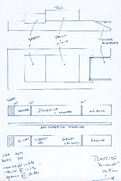

  19. Tad
    Tad New Member
    Nov 4, 2004
    14
    Gabriola Island, BC, Canada
    In sticking with the TRY brief, at 30m, I submit the following.
    I always start with a freehand pencil sketch to establish where we might be going. I will often submit 10-20 of these quick sketches to a client and see if any strike some interest. Often some will be judged terrible and some okay, then I'll try to combine features of the okay profiles. Then we start looking at arrangements, and end up re-doing the profile all over again. And so it goes.
    Tad

  20. TRY
    TRY Senior Member
    Sep 6, 2004
    269
    cannes
    Just for fun!
    Hi Tad,
    The online design game is just for fun, see how people react to the powercat idea.
    Nothing professional here.
    Sorry if my previous reactions were misleading!
