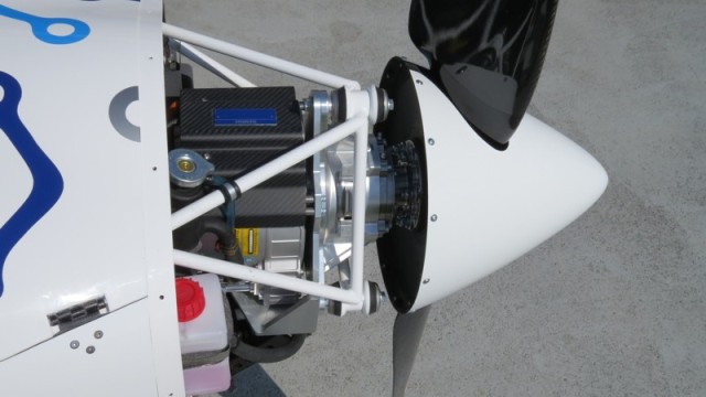

    The light aircraft company Pipistrel in Slovenia has developed a basic trainer with electrical propulsion and quick exchange battery packs for flying training. It can go for an complete hour of traffic pattern work, then the battery pack is exchanged in 2 minutes and the next student / instructor pair is taking over.

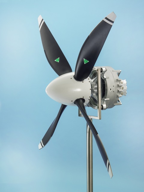

    Siemens has developed an electric motor for light aircrafts up to 2000 kg max. takeoff weight, with 260 KW power and a weight of only 50 kg. Means a power to weight ration of more than 5 KW per kg of weight. Due to its low speed of only 2600 RPM, the motor can drive the propeller directly without an reduction gear. A new record as far as I know.
    Now we just need the battery for this motor and electrical flying in a Cessna Staionair for example would be possible.

    It would be great as the generator part of a marine genset.

    ~348 horsepower......... That's impressive, motor doesn't look much bigger than a alternator.
