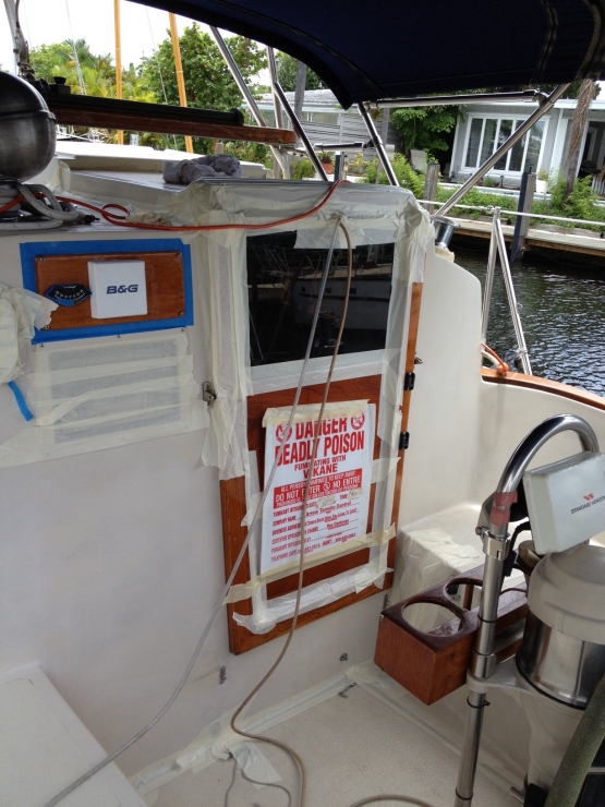

    Gassed the boat today...
    [​IMG]
    Checked prices with 3 termite companies.
    Picked the cheapest as the gas are the same, and the termites are the same.
    Prices varied from $950.00 to $500.00, all 3 with a 1 year warranty.
    Sealed the boat good and even taped over the exhaust port and the 4 bilge pump thru holes. Measurements of the gas 6 hours later confirmed no leakage and therefore all bugs and eggs dead..:mad:

    7E836913-D470-4FEE-B49A-B6FB3150C2D4.jpeg Picture taken during the gassing.
