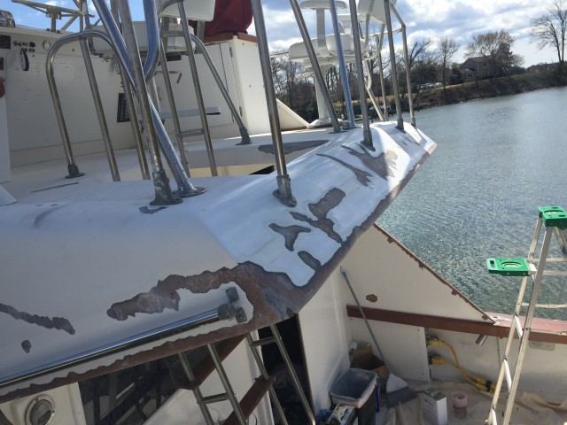

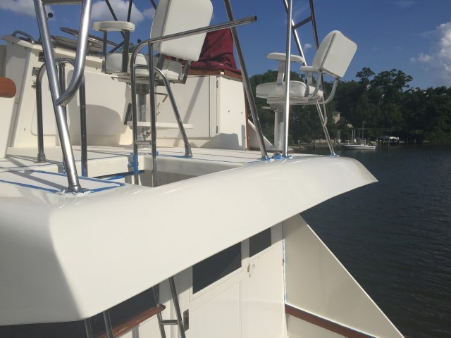

    I removed this on my post 2 seasons ago. My teak was also in bad shape and deteriorating. You can expect to find a bunch of rotted core. On mine, it appeared that there was no effort to seal the core aside from the teak trim and the sealant Post used when attaching the trim. It would have been MUCH better had post completely encapsulated the core with glass.
    Its a challenge because it is a horizontally and vertically curved area. I opened mine up, and then used whatever i could (screw drivers, files, etc) to scrape out the fully rotted sections of mushy wood. Then i let the area dry for 3 or 4 weeks. Next I brushed on epoxy to all the exposed wood. followed by thickened epoxy, and pieces of marine ply coated in epoxy and cut to size to fill in all the jigsaw puzzle like areas. When that all cured i went back with thickened epoxy again and built up the area and applied a layer of fiberglass mat (here i made an error). after it all cured, i sanded, filled, sanded, filled, sanded..... until i had the right shape to prep for paint.
    The error i made was going too light on the fiberglass mat. i was concerned with making the radius' so i wanted to use light weight mat. i wasn't concerned with structural integrity, i really just wanted to seal the core, so i felt it was sufficient. Well, now i have a couple of stress cracks in various parts of the overhang. If i were to do again (which i'm going to have to eventually) i would build up the area with more mat...over build it.

    These pics don't show the rot, but here is a in process pic and one after

    Your end result looks pretty nice.

    Thank you for the info, and looks like an awesome job.
