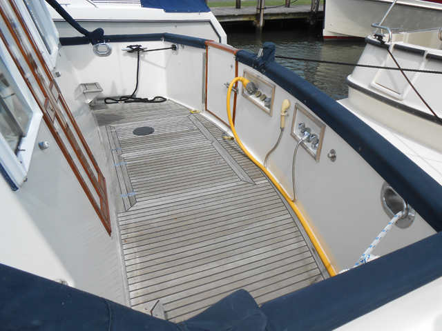

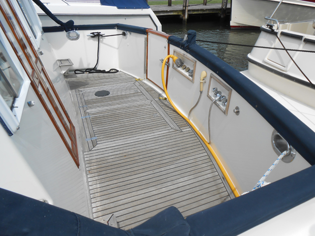

    We have a 3 year old, 44 ft. power boat with exterior teak along the swimstep, and inside the cockpit.
    I have been using Simco, Natural oil, and it looks great for about 2 weeks, then it fades out. The attached pic is the same day after cleaning/oil, but just wanted to show the boats teak.
    It's not a high end boat compared to other 44 ft boats, so the teak thickness is marginal.
    I have read through some teak care articles on the web, but I wanted to run this by this Forum because I know a lot of folks on here deal with teak care, and on boats much more $ than mine.
    1. No hard brushes to remove the Simco stain? A soft sponge, and the weak Oxylate or equivalent solution?
    2. Considering this is not thick teak, is it ok if I lightly sand with a rotary sander?
    3. Can I sand every couple years?
    4. For cleaning it every couple months, what are people using? I have seen salt water mentioned a lot. Any other products out there?
    5. If I follow the above protocol, will the teak have a nice light brown appearance, and not go grey/silver?
    6. Am I reducing the life of the teak by not oiling?
    Thanks in advance.

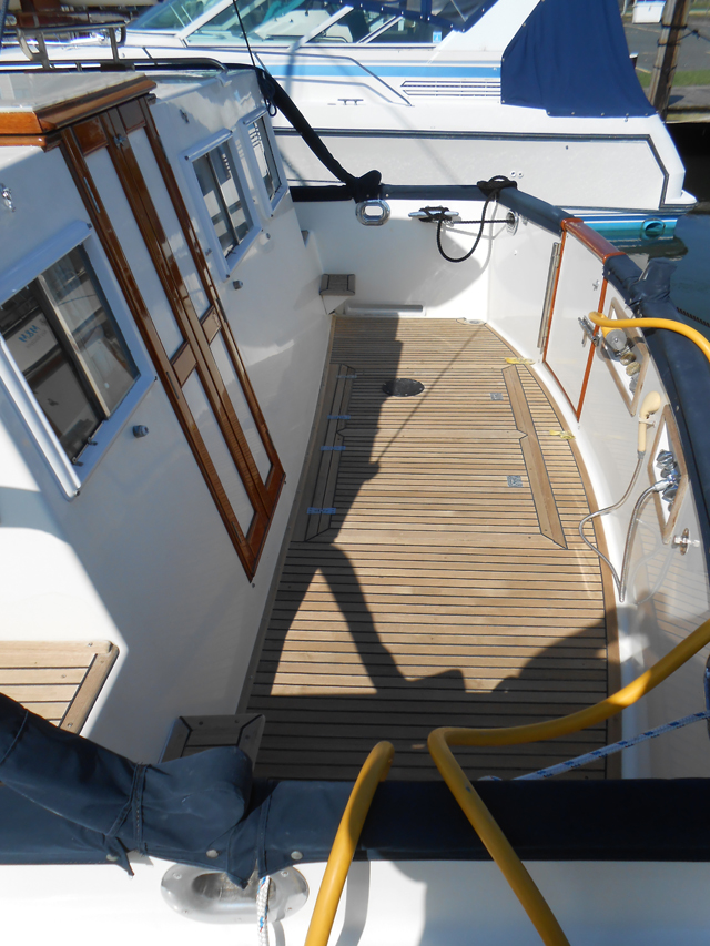

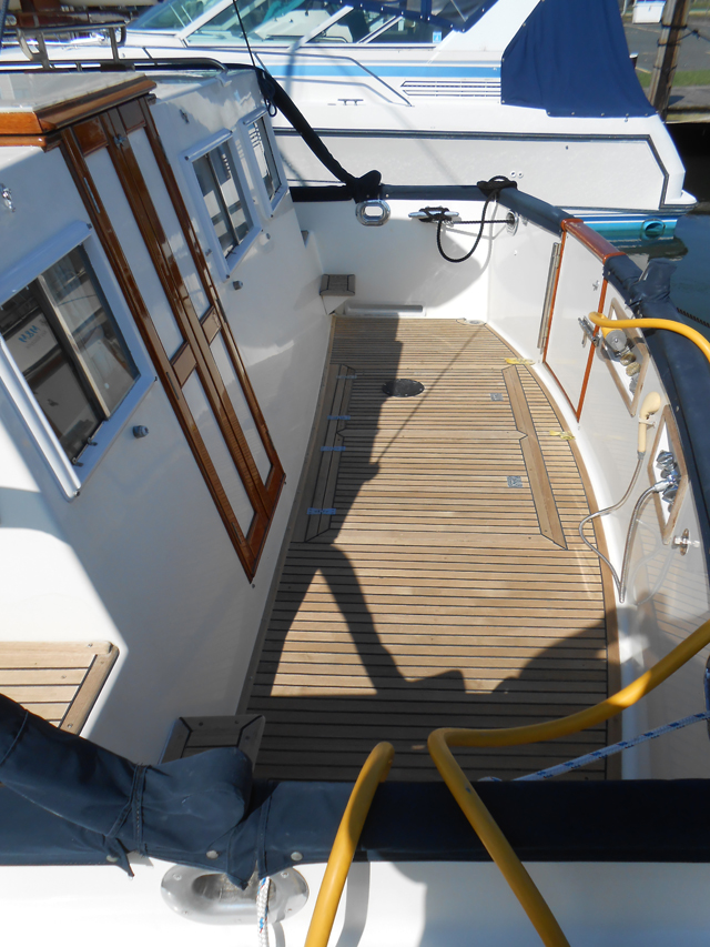

    after.jpg before.jpg I like the sudsy ammonia cleaning, allow it to dry, followed by Star-Brite Teak Brightener applied with a wide nylon paint brush. The result is a natural blonde teak color. After and before photos.
  10. Capt J
    14,434
    Yeah, that's how it comes out if you use Gary's Golden Teak 2nd, same as photo's above.
