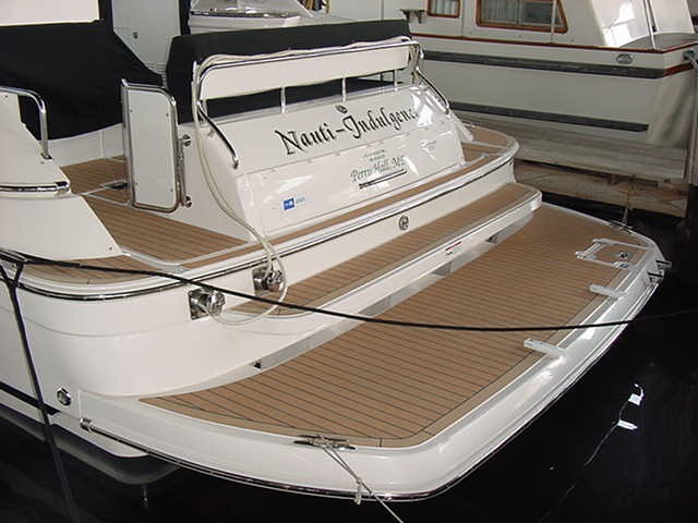

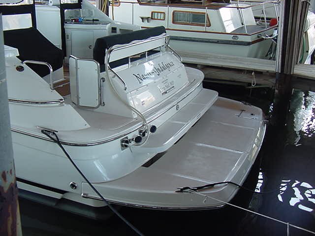

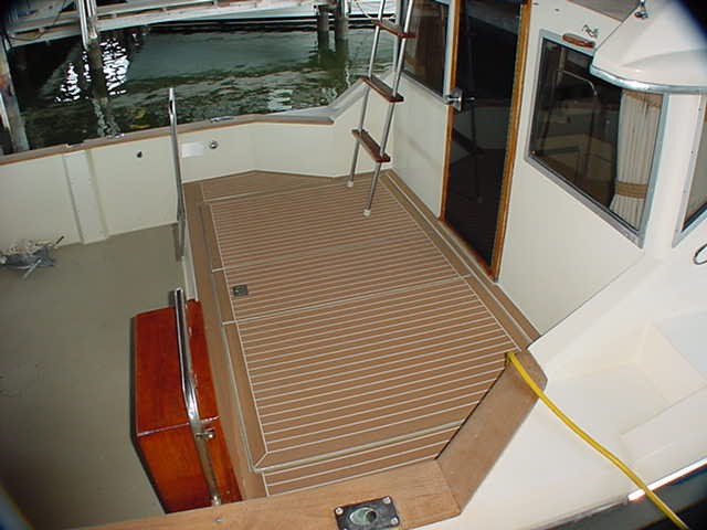

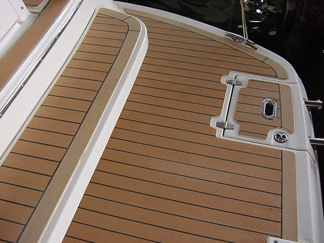

    I have Flexiteek 45mm white on my 31 Chris Craft engine hatch deck area. I'm quite happy with the results and I think it looks great with my existing teak covering boards. It cost around $75/sq ft installed. It does get warm in the sun, but not too warm to walk on in bare feet. Curiously enough, the original Chris Craft dark beige color on the lower aft deck area does get too hot to walk on.

    No doubt. Flexiteek works best on late model fiberglass small craft. On a larger yacht with crew to maintain her- it should be the genuine article. Real teak decking and trimmings all the way.
    You must admit though, the PVC stuff sure does dress up a plastic deck and platform!

    Your thoughts on fake teak are certainly valid. However, I think the Flexiteek is an improvement over non-skid. It sure changes the look of this Regal 4460. For most owner maintained boats, Flexiteek is a good choice.

    I have never heard of Flexiteek coming un-glued on its own. In fact, I recently spoke to a guy who had to take a section of Flexiteek up off the deck of his Jersey sportfish. He needed to replace a fuel tank that was below. This guy and his father worked with hammers and chisels for the better part of a week. He said it was quite a task. They got the deck panel up, undamaged. He plans to glue the Flexiteek decking back down after the tank replacement.
    Some of the other boat owner installed, do-it-yourself decking products may be having installation failures. That would not be a surprise.

    That doesn't sound like the same stuff. The stuff pictured I believe comes in a sheet. What you're describing sounds like a substitute for non-skid.
