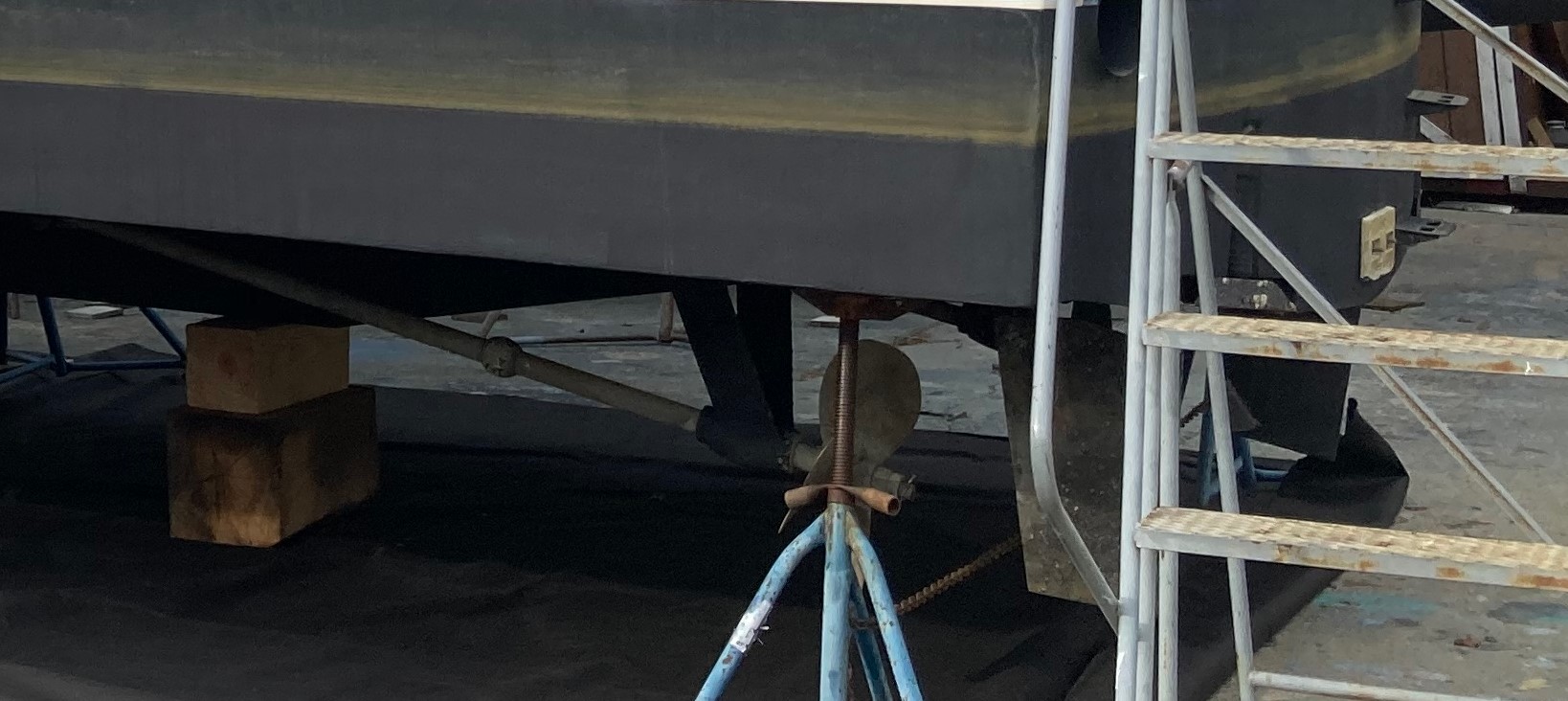

    Not only didn't notice anything wierd running but never noticed it during survey haul out, even taking a picture. I checked rudders for dings along edges etc but never noticed the difference between sides. Will be at yard tomorrow, have to see if can pull now (boat was "just" blocked for winter) or need to wait till spring when they can get travel lift near it again.

    Stock rudder???
    Looks better than stock is why I'm asking.
    Before and after pulling the rudder; thoroughly check the upper rudder post pillow.
    Paint looks great for a backing boo-boo.

    I'd guess stock? Not sure what/when PO hit something backing hard enough to bend that. Really big shark? (they caught one that filled reached from cockpit floor to hardtop I've seen picture unloading) This picture is from the survey haul-out. I had new bottom paint over the summer.
    I had to check rudder mounts/packing/upper supports on my winter work list which the yard did before haul and looked fine on the inside. Was pretty surprized when noticed the bend on the outside.

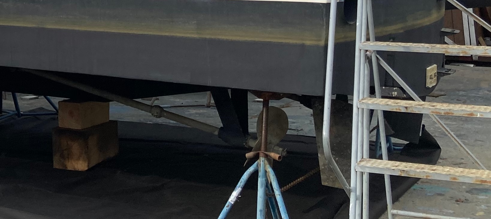

  16. Capt Ralph
    12,736
    Is that primer on the shafts? Looks like paint and a couple of barnacles on the back of the port tab.

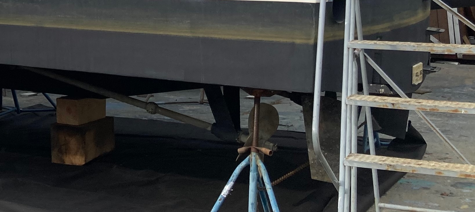

    For the definative "how flat is a Post bottom" I offer this. Get out your protractor.
