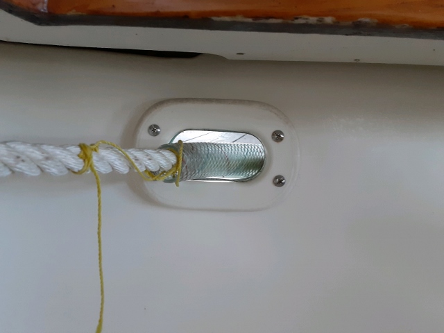

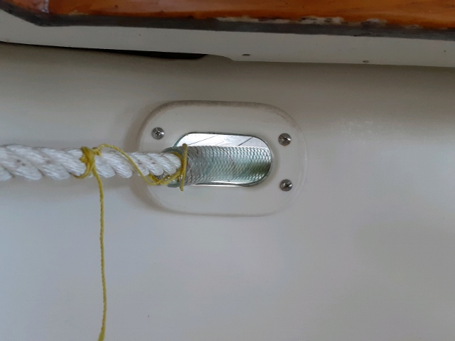

    Mine were beat up too.
    I used Seafoam Starboard to replace them.

    Excellent job, btw. Did you paint them ? Not sure if Starboard holds paint? Does it?

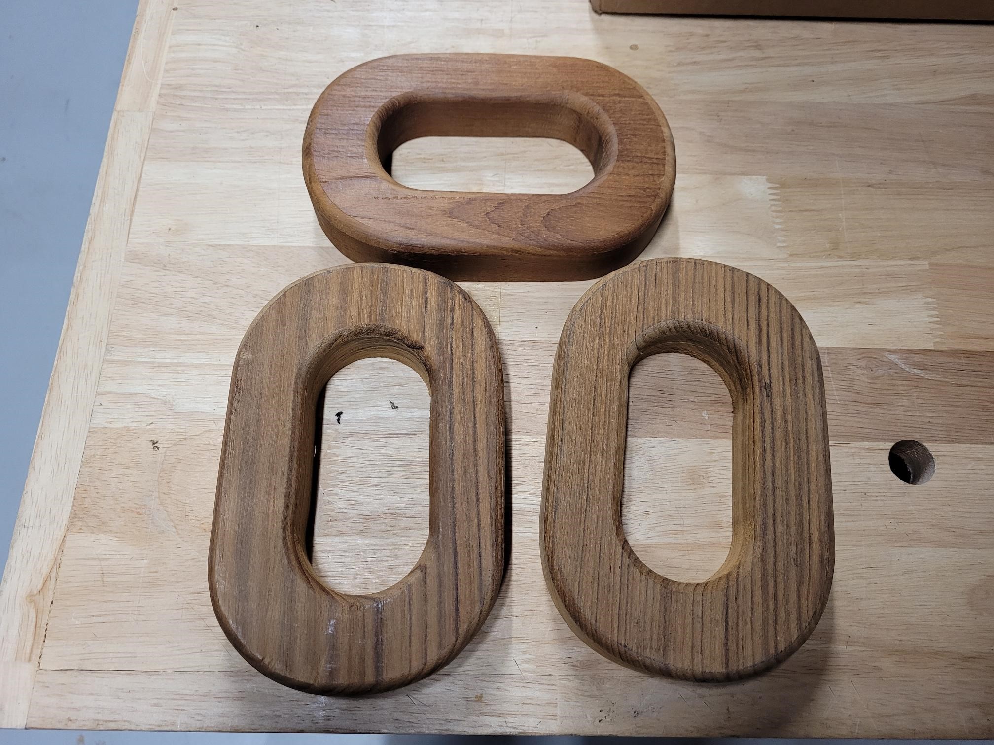

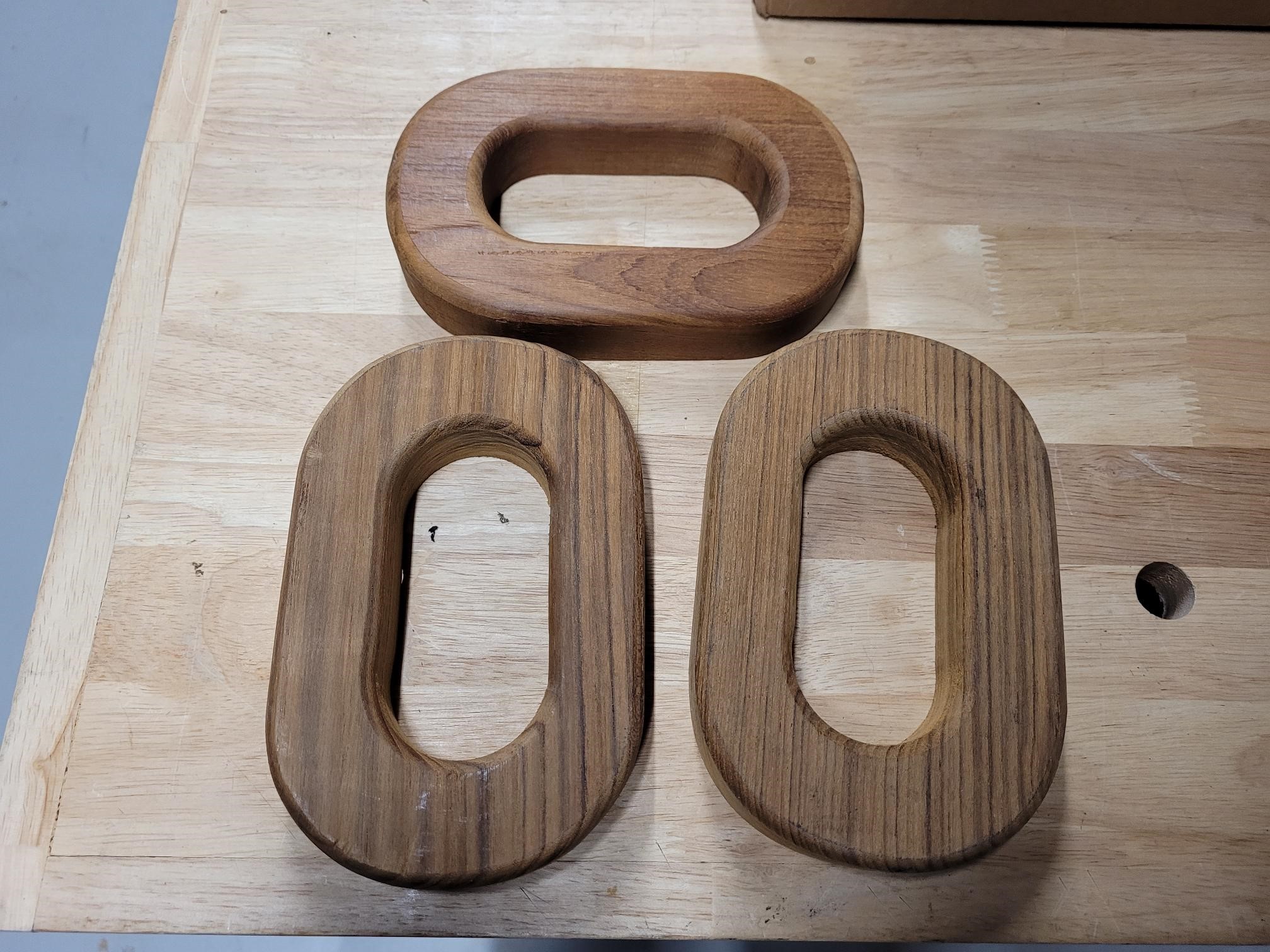

    I have three of them.
  15. Donzi 54
    Donzi 54 Member
    Oct 21, 2009
    166
    Point Pleasant, NJ & Morehead City, NC
    houser 2.jpg All are new and not drilled

    Thanks. No paint.
    I believe you are correct, Starboard will not hold paint.
    The Seafoam color is a perfect match to my gelcoat.
    I made antennae bases, backing plates, and access doors from it.
    Blends right in.

    Look the same. Size on mine is 4-1/4" x 6-1/4" outside dimension.

    They should be they came from Post when they were in Mays Landing. They are 1" thick solid teak so you may need to plane them to the proper thickness to match yours. Hole opening is roughly 4"x2".
