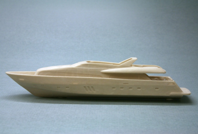

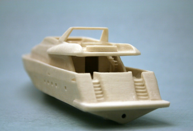

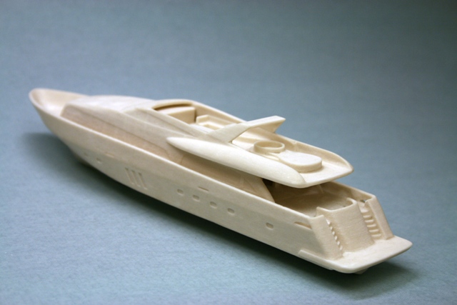

  5. coismov
    coismov Member
    Feb 4, 2006
    94
    Milwaukee, WI
    Sorry its taken me so long to reply, I had a cross-country move, so everything has been a little hectic. Anyway, here are a couple images of the model from the rapid prototype printer. The model is about 12 inches long to give you some idea of scale.
  6. brian eiland
    brian eiland Senior Member
    Jul 28, 2004
    2,955
    St Augustine, Fl and Thailand
    What is the largest size (length) model one moight make with your system?
    That looks to be pretty good detail at that size, so my thought is it might even be better in something 2 to 3 times larger?
  7. coismov
    coismov Member
    Feb 4, 2006
    94
    Milwaukee, WI
    I was pretty happy with the detail, particularly the spiral stairs up to the flybridge. The dimensions of the print bin on the Z Corp printer I used were about 8 X 10 X 8 in. I placed the model diagonally across the bottom of the print space so I could enlarge it beyond 10 inches. However, although I did not get a chance to try this, a model could be cut into 2-3 pieces, printed in sections, and then joined later. This would allow for a workable diameter on smaller features such as railings and deck fittings. The printer company also has a models with a larger build size, and full color capabilities. I've seen it produce some pretty intricate models though, from product design to architectural models.
