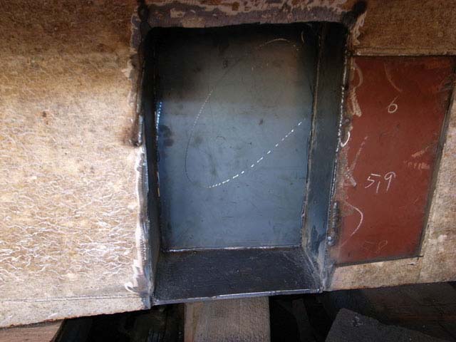

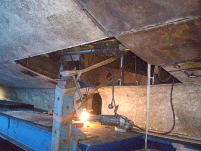

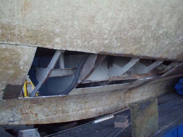

  7. david_japp
    david_japp Senior Member
    Feb 7, 2005
    369
    london
    Vintage 61ft Feadship restoration
    here are photos of the hull work - next week I'll add some of the work to deck and interior etc

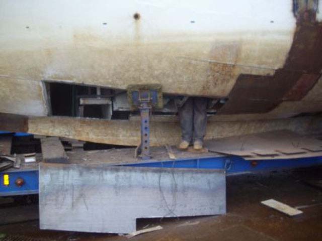

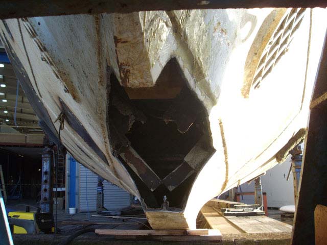

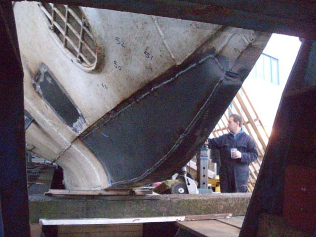

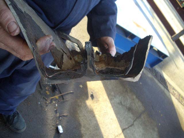

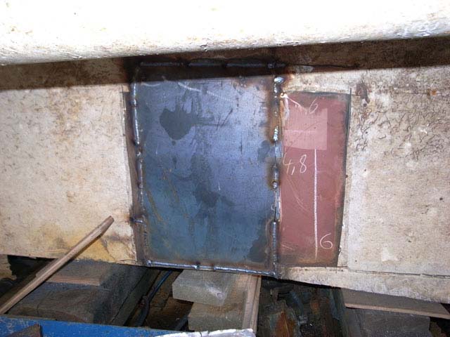

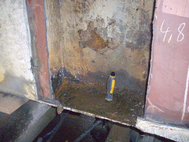

  8. david_japp
    Feb 7, 2005
    369
    london
    Feadship steel hull rebuild
    here are some more pics of the steelwork repairs
