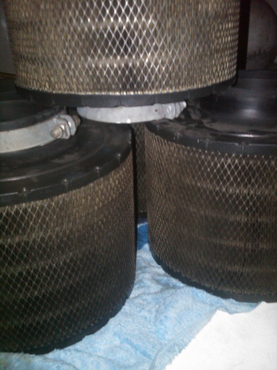

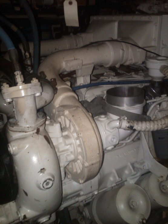

    I was just at the boat & pulled the filters. I did get my hand in far enough to spin the turbo fans. Everything seems fine & they spin freely.
    The filters look a little dirty but nothing alarming.
    As far as turbos go, am I assuming correctly that spinning the blade from the air intake side, spins something inside the larger round housing aft of the turbo fan housing (to the left in the picture)?
    Next up, a quick run tomorrow & I'm jumping in to look at the props.
    Thanks for the tips guys! Keep em coming!!

    They look awful. Run the engines up to high idle again with the filters off and see if the black smoke goes away.
    If it does, get underway and see what happens at full throttle.
  20. K1W1
    7,396
    The larger housing you mention is the turbine housing which contains the exhaust gas driven turbine and maybe a nozzle. It is the end that normally drives the bit you can touch through the inlet pipes which is called the Compressor. The reason it is larger is because it is water cooled.
    Here is an exploded view of one that I think is similar to yours minus the water jacket.
    Google Image Result for http://image.automotive.com/f/tech/15608171%2Bpheader/0904dp_01_z%2Bturbochargers%2Bturbocharger.jpg
    Cheers
    K1W1
