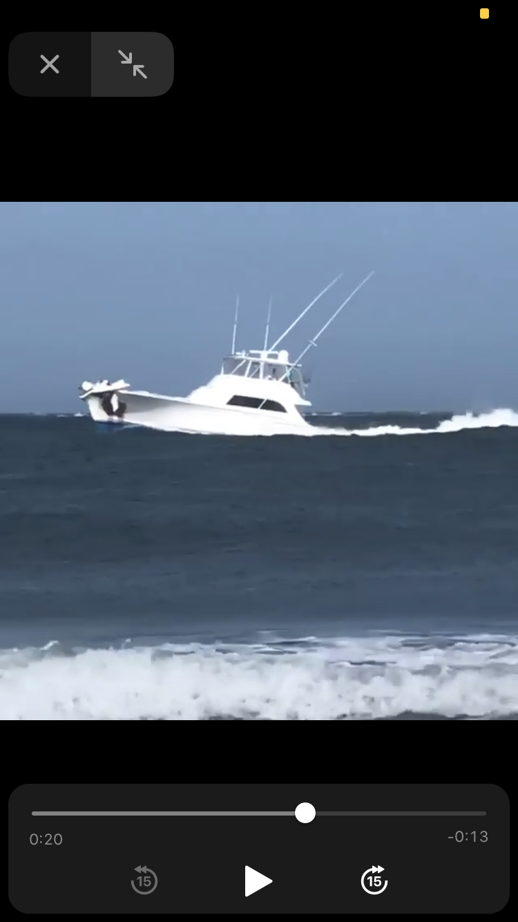

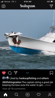

    Carolina boat heading back into Morehead inlet came off a wave and lifted the deck. Lots of bow damage. Video and hauled photo on Instagram by carolinaoffshore

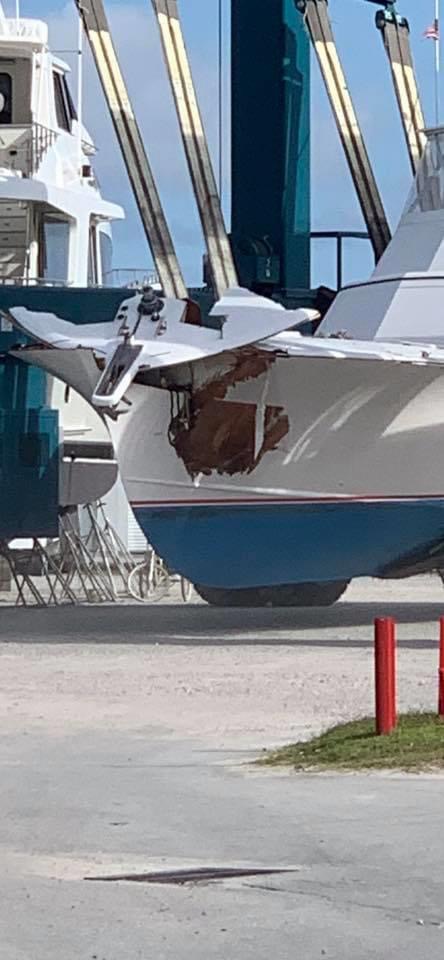

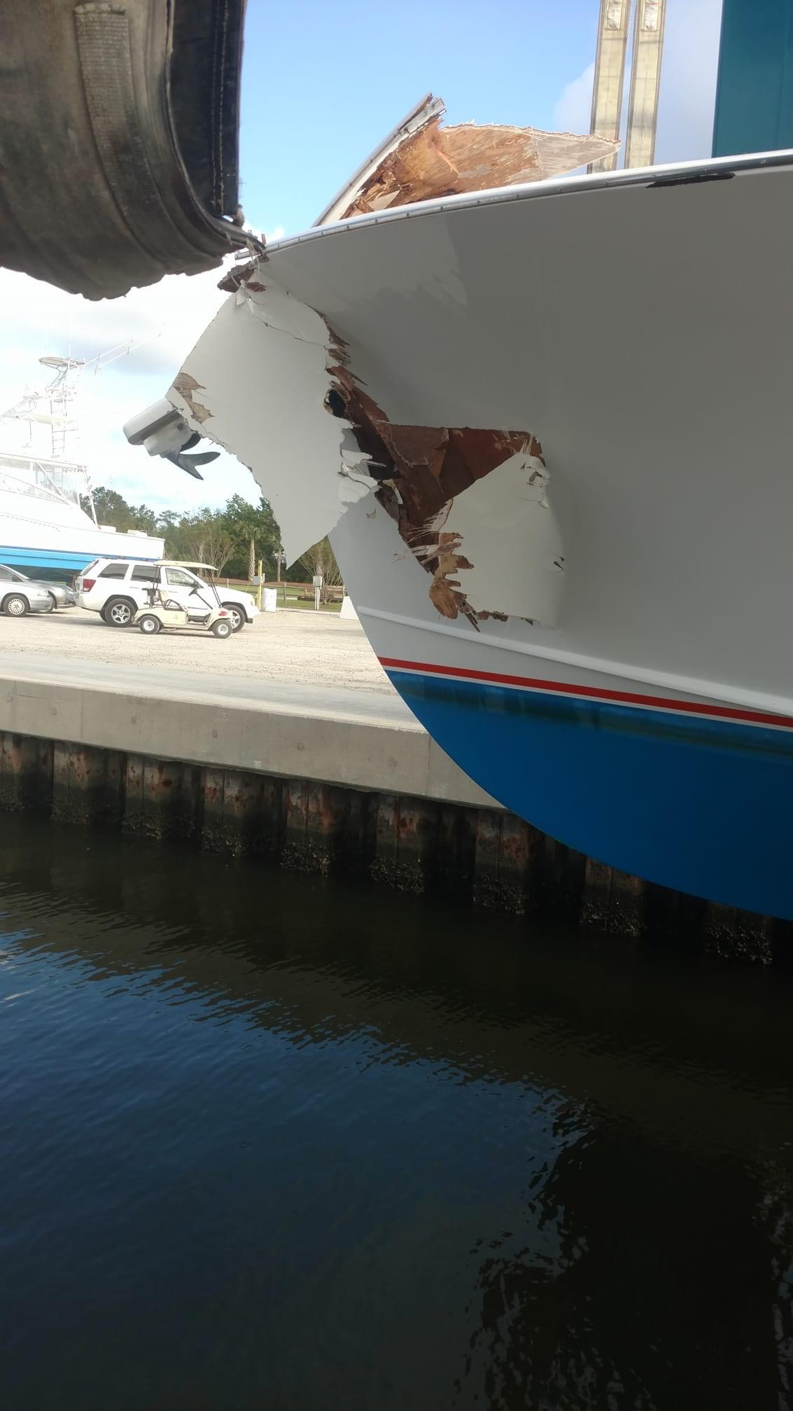

    Here are some pics of the damage. The first pic is of the boat running after stuffing the bow.

    can see hints of darkness in the plywood coring near the rub rail area of the deck. Just have to wonder about the conditions up near the pulpit where the leverage for the wave existed. Rot? Certainly weakening was there as well as along the cap rail in that area. That pulpit can really take a beating in big sea. Not an item to overbuild in and of itself and then not thoughtfully tie into the vessel structure.

    Seeing that the bottom below the waterline has no damage, this doesn’t seem likely. I assume their is some rot from moisture in the fwd rope locker

    The video of that boat entering the inlet (appearing to be wind against tide) documented the fall of the bow into a sea and the anchor platform releasing. As the bow came up you can clearly see the topsides peeling away.

    • Topside don't just peel away without failure of lamination or hardware. Moisture (rot) in the wood coring creates that ability to both move as well as release. Clearly the pulpit was the leverage tool for this.
