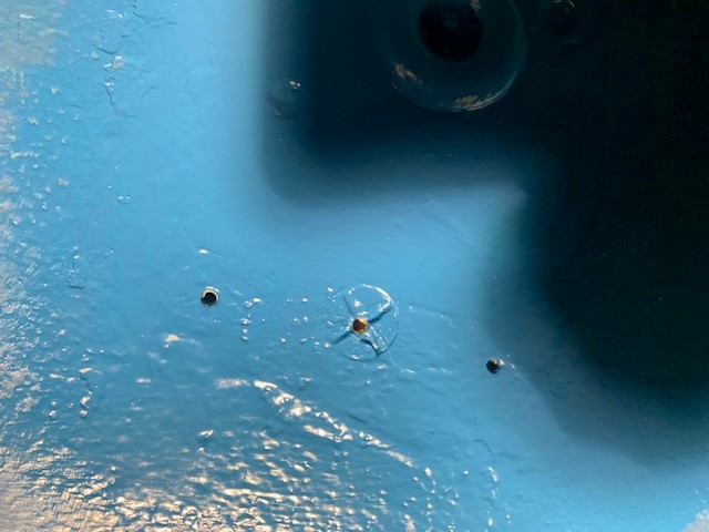

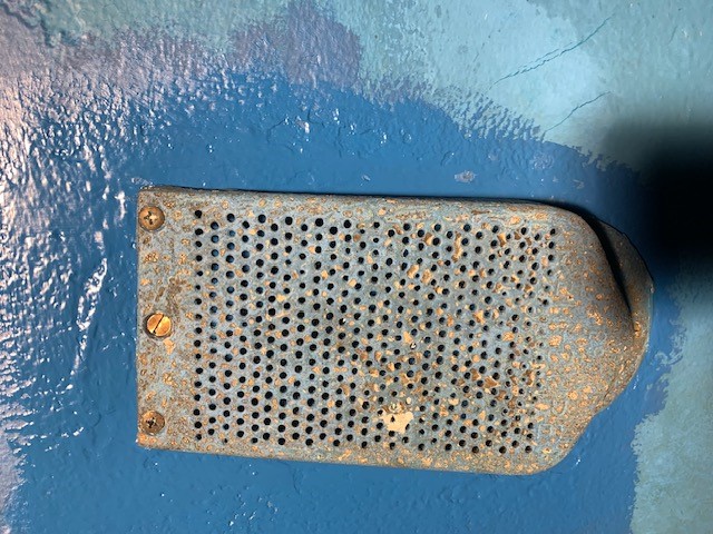

    Have not had any problems on the inside of South Bay style strainer. There is also a full Perko bronze strainer on the inside, just after the valve. No issues there and rarely have to open it to clean it. We don't get much growth up here due to colder water. Only reason I removed the outside strainer is I needed to replace the sea valve and when I removed the valve I disturbed the 5200 on the thru hull so removed that to re-seal it. Of course, that's when I broke the bonding wire bolt.
    Here's a few pics of the threaded bolt and the strainer back on. The slot head screw is what threads into the newly installed 3/8 thru-hull bolt.

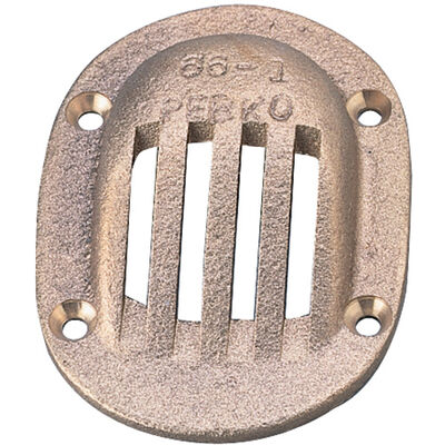

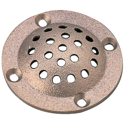

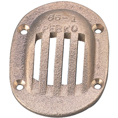

    Our swamp ole school was to avoid any scoop action from these types of hull strainers on a gen-set;

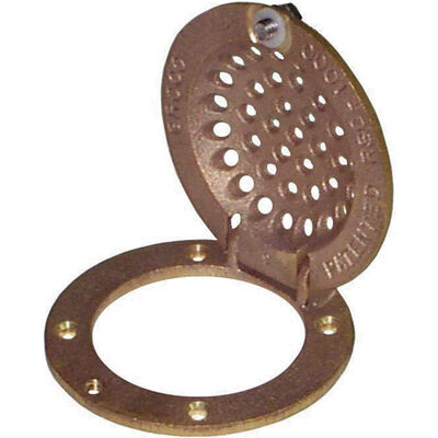

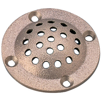

    And use these;
    Never forcing water up to a non-running gen-set.

    One day, If I ever had a real problem, I would install one of these;
    After 20+ years, not been a problem.

    That particular strainer does not have the holes in the back of the scoop area. I have a few other ones like the round screens and smaller grate type style shown in your pictures. I’m unaware of any issues from water being forced into the gen but then again, this gen is almost always running if I’m motoring. I could certainly drill a few holes in the back of the scoop but again, not sure I have any issues here. What would be an indication or problem created from water being forced into the gen if it were not running while motoring? Even if water were forced past the pump wouldn’t it just go thru the heatX and exit the same as if it were running?
