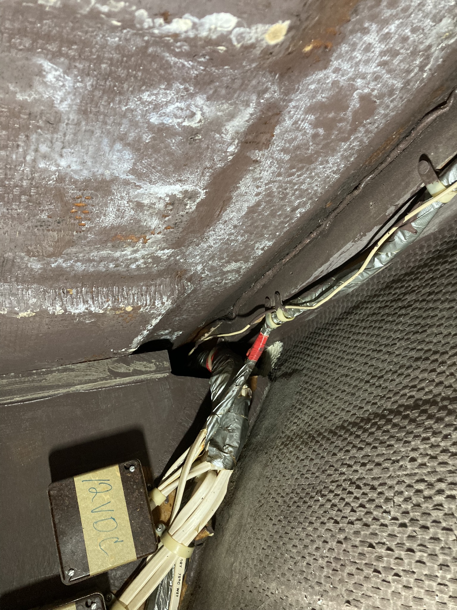

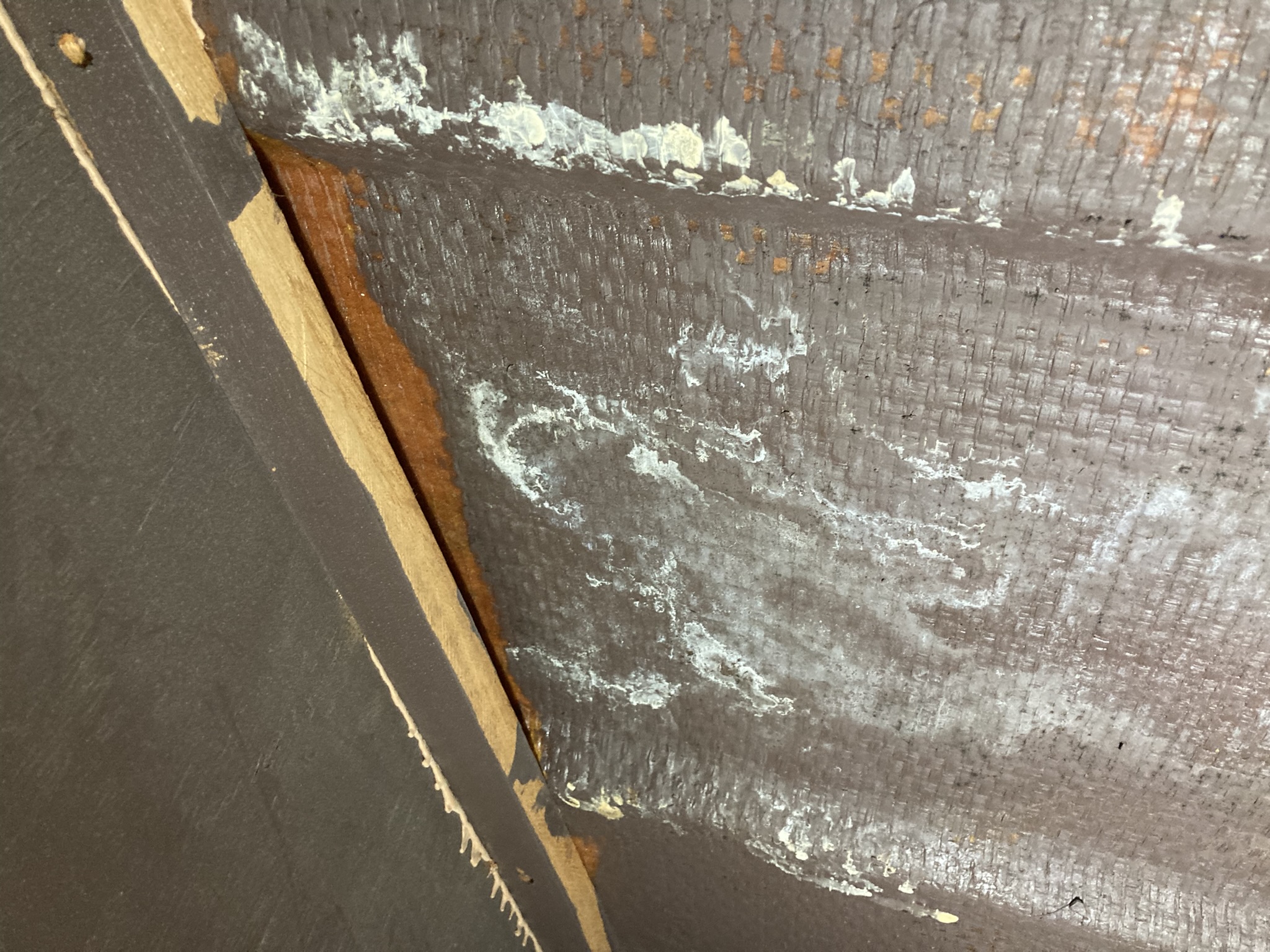

    A couple pictures showing the underside of the foredeck. This location is just outboard of the aft port hatch.
  7. Capt Ralph
    13,737
    Looks like somebody has been in the core already.
  8. Greg Page
    Greg Page Senior Member
    Mar 4, 2017
    454
    Annapolis MD
    From what do you get that? The brown paint is the same as is on the inside of all of the fiberglass in the boat.
  9. Capt Ralph
    13,737
    Duct tape gives some of it away. Cable hangers also.
    Glass tabbing, paint application, wood batten/spacer and glue.
    Roofing Nails??
    IMO, That is not factory.
    Are those white stains from salt or leaching from the resin?
  10. Greg Page
    Mar 4, 2017
    454
    Annapolis MD
    I think the white is light mildew since the space is accessed from a normally closed off cabinet? The paint is in the back of all cabinets, anchor locker, and anywhere else you can see the inside of the hull so I'm pretty sure is factory. The wood blocks are in the cove of the otherwise hollow back side of the fiberglass toe rail, and is where the cleat mounts so I expect is the original doubler. It looks the same on the opposite side behind the dryer so either the whole boat was re-wired or it is probably original.
  11. Capt Ralph
    13,737
    Your there, I'm not.
    Just my thoughts based on a couple of pictures.
  12. Greg Page
    Mar 4, 2017
    454
    Annapolis MD
    Not questioning, just asking. The white came off with a simple pre-wetted wipe. About the same on the wall and floor in that space. Doubt it has been cleaned for years (decades?) since not much reason to crawl into the cabinet to get to it. There is silver tape around the main wire bundle in other places so was used to that. Prior owner used nasty black tape so it wasn't him. Original owner I can't say.
    Since the deck doesn't seem soft anywhere (but looking for it I can find the location/edges of 'thick' sections elsewhere around the deck) so I'm going to leave it till next summer and then look for any changes.
    Thanks
    cleanslate and chesapeake46 like this.
  13. chesapeake46
    chesapeake46 Senior Member
    Jul 26, 2009
    1,844
    Although my Post is older, I can verify the use of roofing nails here and there.
    I laughed at that when I first discovered one.
    No factory duct tape though.
    Same brown paint but they used a gray/white kind if electrical tape to wrap the wiring
    Greg Page likes this.
