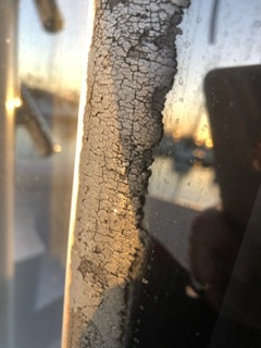

    Any ideas on how to replace this rubber around the two sliding doors on Carver 450? As you can see original sealant around curved glass is crumbling.

    Never got any suggestions. What we wound up doing was curing it off clean next to the metal trim. We then taped off about1/2 inch away from metal trim and filled with black caulking. Came out clean and straight and no leaks when sprayed with the hose.
    now I need to find the right material to use around the windshields.
