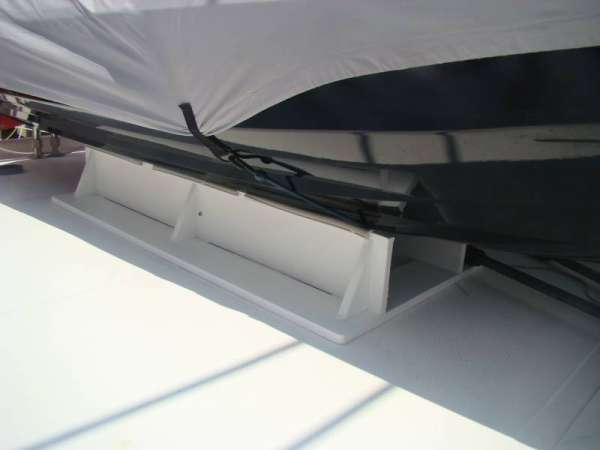

    as to chocks to hold the tender, here is what i did. it's about $100 worth of starboard... i've done two sets, one for the jet ski on the 70 footer i run, and one for the cat boat on my on boat. a lot cheaper than the custom made alum. chocks from Marquipt or other suppliers...
