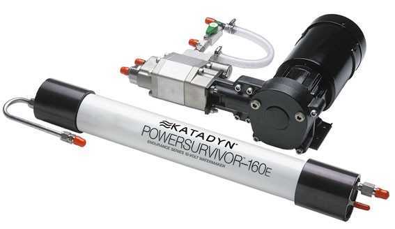

    Katadyn Power Survivor. A very simple DC system which is used by sailors all over the world. Simple, small, low power requirements and comes in 12 or 24 Volt versions with different output rates. The manuell operated version is part of the SOLAS rescue equipment of commercial ships. Very reliable stuff. Made in Switzerland.

    It does not make any difference whether its a sailboat or a sportfish. Your requirements of 25 Gal a day, produced during about 8 hours of sunlight by solar panels is no problem.
    Blue water sailors run their 12 Volt DC desalinator on their house batteries and recharge their batteries either by a towed sailing generator, a wind generator or by solar panels.
    Taking your example of 25 Gal a day, produced during 8 hours, you would need the Powersurvivor 80 E, which makes 12.9 L/h on 12 Volt, 8 Amps per hour. That means, a 100 Watt solar panel can run your desalinator and feed the access power into your house battery. On a cloudy day, you can run him on your house batteries. Your Diesel Gen or your main engine alternator will recharge them in this case in less than 30 min.

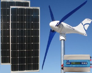

    If your sportfish has an electrical setup for independend liveabord, these 64 amps can be spared easily. In Europe, we see a lot of smaller liveaboard yachts in the 30 to 50 ft range with a combination of solarpanels and wind generator for complete electrical independency without shorepower or diesel generator.
    If you need more electrical power, I would try a combination of solar panel and 12 Volt wind generator. The wind generator can be mounted on the foredeck and be taken down, when the boat leaves the harbour.
    And believe it or not, that desalinator produces perfect drinking water. Thats why circumnavigators completely rely on their watermaker and never take potable water from shore.

    I have the Katadyn Powersurvivor 160 E, 24 Volt Version installed in my 50 ft displacement Riverboat. It works flawless and produces excellent water. The low power consumption makes it very suitable for the DC to inverter setup of smaller boats. I am very reluctant to take shore water because of uncertain quality. With a production rate of more than 500 Liter a day (we never reach the predicted 610 Liter per day, because of the lower water temperatures here), we can waste :) potable water like at home.
    On my larger sailboat, we have the 24 Volt 160 E as a backup system, just in case the HEM Duplex, 400 Volt AC watermaker fails.
    The hand operated version is part of the SOLAS equipment of all life rafts on our commercial ships and we have the smallest version, the 40 E, 12 Volt Version, build into the free fall lifeboats of our cargo ships. This version operates on 12 V DC and can be operated by hand.
    The Katadyn guys come from the outdoor / survival industry. They know what reliability means.
