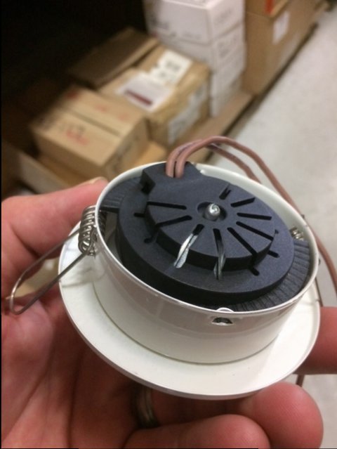

    so, this is a pretty stupid question but.... I have ceiling salon lights out that need bulbs replaced. I have tried prying them down off the ceiling with no luck... no way to get to them otherwise.. am I missing something??!! 2003 52 C

    I sometimes use 2 butter knives to pry them down. I slide 1 on each side of the fixture and gently work it down.
    Replace the bulbs with LED's. Cuts the heat down.

    They appear different than mine. Mine are held in with pressure clips that expand out from the fixture.
    You should call Viking in NJ. Give them the hull ID and see what they say.

    took your advice and contacted viking.. didn't want to screw up headliner... they got back to me early next morning with great instructions and a picture!! Will take your advice on the led's, as the previous owner had already changed all the cockpit and flybridge over.... thanks!!

    I am assuming you have a Viking. On mine it was basically friction that held them in. Carefully get a blade or screw driver between the light and the headliner and work it down a 1/4 inch or so and then get your hand around the light and turn it back and forth while pulling down. I don’t know if we have the same situation but that was the way mine were. Do you have the bulb that looked like a small cylinder with 2 prongs? I believe halogen and yes they would get hot as hell quick. I switched mind to LED and was glad I did.

    yes a 2001 viking convertible, I will try to find some pics of the light face, it almost looks like the glass cover has slots that will allow that to come out to change the bulb. Every time I have messed with it, it seems to take so much force and I have been worried about breaking the tab or glass (plastic) cover etc. Thanks for the reply

    Had the same on mine (not a Viking) it got stuck to the leather of the headliner real good, was also afraid to use force. Used tools intended for car trim, worked a treat and didn't cost much.
    Replaced the G4 halogens for LED - worked super and went from 400 Watt to 35 or so, also it cut the heat. However, be aware I had to replace the transformers and dimmers as the LED need the ballast. Otherwise the LED may blink and/or make annoying noises....
