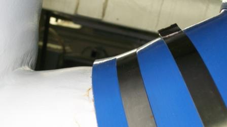

    I would recommend that you check to see if you have anti-crush sleeves in your fiberglass before you overtighten the clamps. This is a stainless sleeve that fits inside the fiberglass so that it protects it from collapsing. I have seen a number of times that in an effort to stop a leak, clamps are tightened to the point that the now they have a fiberglass issue.
  11. Jorge Lang
    Jorge Lang Senior Member
    Nov 17, 2003
    298
    I found this photo showing what might happen if you over tighten a clamp. You can see that the fiberglass has collapsed at the lower clamp. Carl, I hope I have the attchment size correct.

    It's not so much the Trident or any other maker of hose. It could be more that the fiberglass is out of round. As far as using a sealant, this reminds me of the old Fram commercial, "you can pay me now, or you can pay me later." Sooner or later, that hose connection is going to need to come out. A sealant will make this job much harder, not to mention the added cost of replacing the hose. I have also seen where clamps are not staggered to make a good seal.

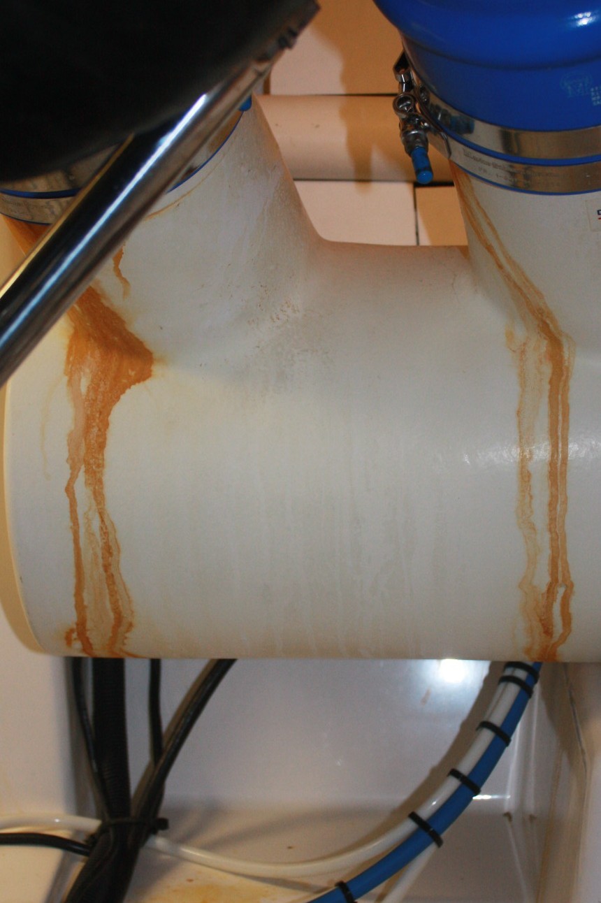

    Exhaust & Muffler picture
    Here is a picture of the starboard side where the exhaust and muffler connect.
  19. Capt J
    14,432
    Cold weather can causes silicone rubber hoses to contract slightly, and it looks like the hose clamps are loose. You can use a product called WHINK on the rust stains. Just put it on and let it sit 10 minutes, maybe lightly brush it and rinse it off.
