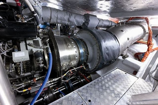

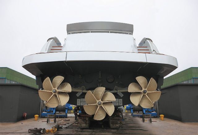

  10. HTMO9
    HTMO9 Senior Member
    Jan 13, 2009
    1,670
    Triple engine yachts
    How about this nice little yacht with 3 x MTU 16V 2000 M94 and 3 x surface props, the Pershing 108 :). But the 3rd engine is most likely not for fuel economy, when going single engine. Most triple engine boats like the above or the Mangusta 165 with 3 WJ or equivalent, use the center engine as a booster. The center propulsion train has no steering, so its either twin or tripple for speed.
    The boats with tripple engine via shaft, wheel and rudder are mostly PT boats or other official duty types like coast guard, fishery service or police / custom patrol boats or SAR vessels. If they are eqipped with 3 individual power trains, most of them can use any kind of combination, single, twin and or twin asymetrical.
    The bigger German SAR vessels have 3 MTU used for high speed towards the scene and after arrival one or more engines can be geared to high performance water pumps either for fire fighting or assisting in pumping out sinking ships. Loitering or trolling can be done on any engine.
    The decision whether to use 2 or 3 engines is mostly a calculation of weight and engine room space available. Typical example is the new Van der Valk 26 meter RP with tripple IPS 1200. 3 x IPS 1200 make a total engine powertrain weight of 6900 kg, whereas 4 x IPS 900 with same amount of 3600 total equivalent HP have a combined weight of more than 7200 kg and they occupy more space in the engine room. By using 3 x MTU 16V 2000 or 2 x 16V 4000 for a boat, the version with the 3 x 2000 engines is lower on weight but still using more space. On the Pershing 108, the reason for the triple engine setup was just the maximum size of surface props available. A SP, that can take the power of an 16V 4000 M93L does not excist.
    Larger warships use CODAD or CODAG propulsion. Means, several diesel and / or gas turbines are connected via combining gears to one, two or more shafts. By this setup, any amount or type of engine can be used to drive one, two or more shafts for different modes of operation. This allows long range economy or high speed combat maneuvering. The only yacht with this setup, I know, is the Dutch built MY Predator with 2 x 2 diesel via combining gear on two shafts.
    Triple engine for expedition cruising does not make sense. Taking two bigger engines and a special technical setup for single engine operation is more economical.

  12. Capt J
    14,432
    It is usually less efficient in most all yachts to run one engine in a twin engine installation and creates much higher load factors and wear and tear on the single engine running. If the motors are propped to achieve full RPM dependant on both engines running full RPM, then the single engine running is going to see extremely high load factors throughout the RPM range. Electronic CATS will limit RPM to around 1200rpms under these situations and so will MAN's (common rails, I think they limit either 1350 or 1600rpms). Diesels in general get excellent fuel burn under 1000 rpms, so running both under 1000 rpms, versus running one at 1400rpms would burn much less fuel to run both slower if you're maintaining the same speed as running 1 faster.
    The more engines and drives/propellors in the water the more the diminishing returns are. I know on a large outboard center console or race boat. The third engine adds at best 13 mph, and the 4th adds only 7mph say for a boat with twins that does 45-65mph with twins. Extra engines and drives will help with getting a heavy boat or heavy load onto plane and out of the hole. That's why they rigged those 37' Midnight express drug boats back in the Miami Vice era with 5 outboards back in the day. They'd run 2 outboards to cruise over. Run 5 to get the heavily loaded boat on plane, then run 2-5 motors back depending on how much fuel they had and distance.
    I wouldn't want to maintain more than two IPS type drives and engines.....3 would be about MAX...... with 4 engines/drives, they really aren't worth having as they're the same speed efficiency as twin inboards.......

  17. Capt Ralph
    12,649
    Per your link; cruises at 40 kts, max speed 33 kts; seems confusing and unreliable for your point./?
    I'm sure a typo somewhere, but my south Georgia mind (rum influenced) is not in step with your example, can you help me my friend?
