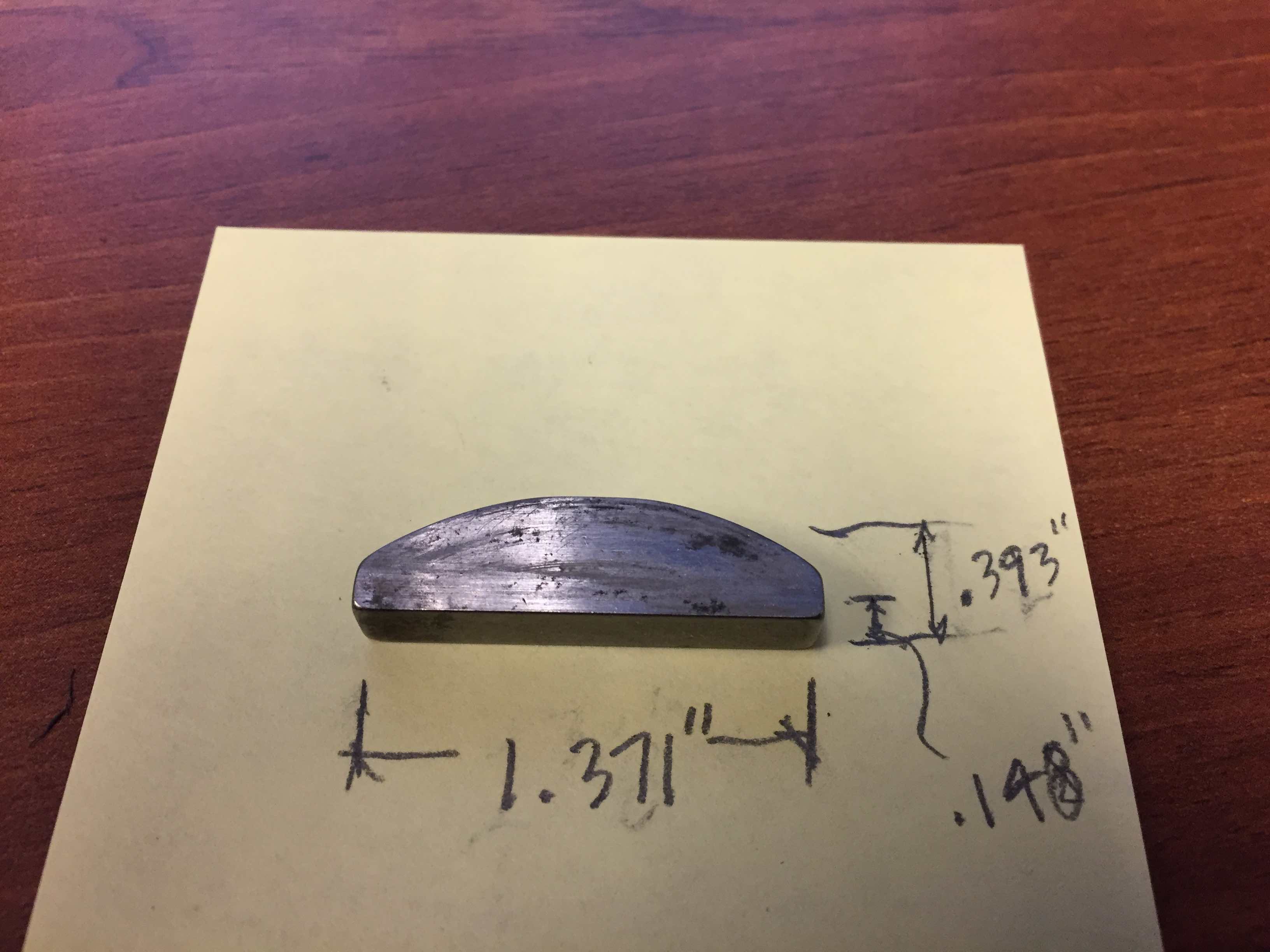

    I have another question.
    My rudders have keyways. One of the inserts (bushings?)is missing for the port rudder. Does anyone know where to find these?

    They are called woodruff keys and should be available at hardware or industrial supply stores. The ends may have to be trimmed by grinding to match.
