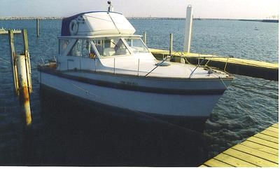

    The Dispatcher model was a 30' steel hull design that was manufactured in 1965 and '66. It was offered in a Expess '65 and '66 or a Enclosed model in '66 only. (the enclosed has salon doors). Hull numbers range from RXA-30-101 to 107 (1965) and RXA-30-2001 to 2007 (1966) only 14 express models. The Enclosed hull numbers are RDA-30-501 to 510. Only 10 Enclosed models were manufactured. The express weighs approx. 12,500lbs. and the enclosed 13,100lbs.
    The Dispatcher was offered with twin 283 or twin 327 Chevrolet Marine engines.
    This information made available from "Chris Craft The Essential Guide" Author: Jerry Conrad, Published by: The Mariners' Museum
    I hope this helps and please send a photo. I have included one from the net. Thanks and good luck!
