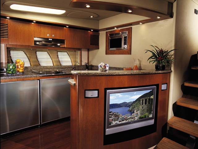

    We have been looking into redoing our galley with granite but the weight is for sure an issue, check out the new 60 Sea Ray, they are using a product called Karadon, much better looking than Corian. http://www.karadon.com/

    Beautiful job in your Sea Ray! Nice!
    Regarding the use of real stone on board:
    The weight factor is most certainly to be recokened with, but here is a perspective on the use of real stone in yachts. The delta (deviation between real stone and whatever else it is that can be used) is going to be less than a quarter tank of fuel even on the smaller boats like my 38' Chris Craft. Having said that, I would encourage people to use whatever stone lavishes their boating experience to the max, and forget about the weight factor. In the event some of the boats are planning on large areas of flatwork, then going to a 2cm thickness or some of the manufactured honeycomb backed products makes sense, but the latter is often more $$ than using solid stone, which can be obtained at any good stone company around the world.
    We installed a 3cm granite countertop in our 40-year old Chris Craft Commander, and while I didn't like the 3cm thickness, we just couldn't find the same stone in a 2cm at the time, and we really loved the slab we found. Therefore we went ahead with it and never looked back. I considered changing house battery locations in order to avoid a listing of the boat, but didn't need to. At 7-pounds per gal of fuel, approximately, just a fluxuation of 10 gallons will be more weight factor than our use of stone on this size boat.
    With the experience we've had on our relatively small boat, I would think any weight factor on larger craft would be even more insignificant than what we have encountered using the solid granite. Here is a link to a thread already posted on YachtForums, about this same topic, and I have posted a photo of our galley upgrade on a 40-year old boat, as a reference to anyone contemplating a galley remodeling.
    Regards, Dogsharks
