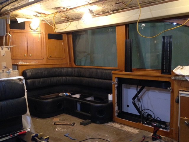

    Progress continues. Settee, dinette, TV Lift Cabinet and misc stuff back in now. We also received the exhaust which was the last bid item we were waiting on. The exhaust sure eats up a lot of space! The electrical work is coming together nicely. Getting down to lots of little details and starting to double/triple check all connections. Salon headliner still scheduled for Monday 5/11 followed by carpet on 5/18. Sorry, no idea why it keeps turning the exhaust photos upside down?
    E8425355-A89F-4EE3-B5C3-BF461E7C8F9F.jpeg 21259CB0-0794-4CA8-AFC7-E3E4E66641E2.jpeg 21259CB0-0794-4CA8-AFC7-E3E4E66641E2.jpeg 63470533-BE17-4735-95FC-02124FA48AD9.jpeg A3B45E89-D17F-4CCD-B11B-56C0B32A93EA.jpeg

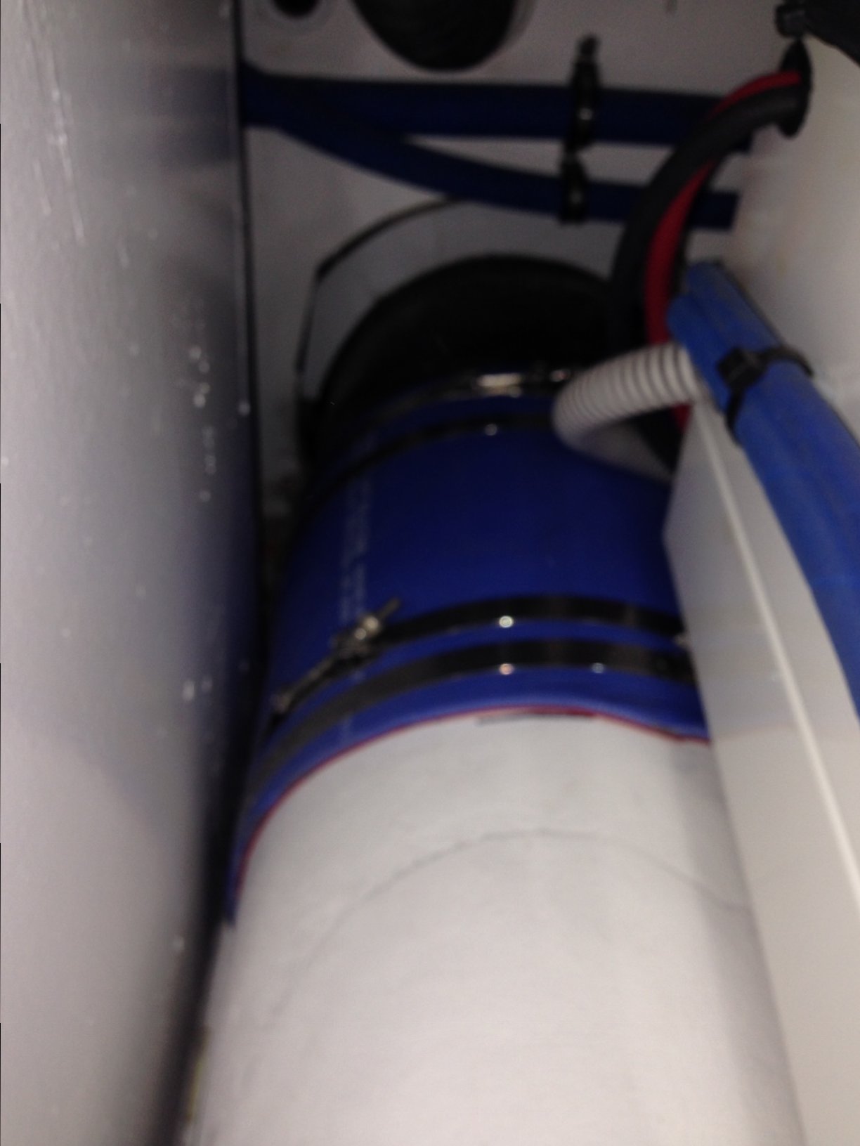

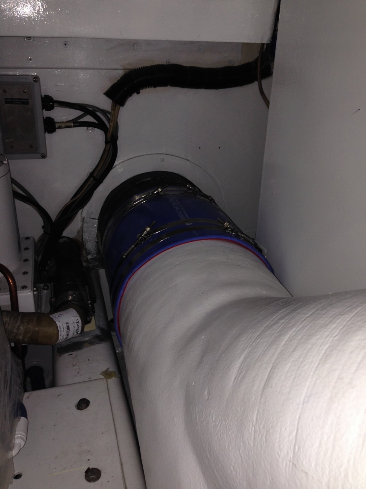

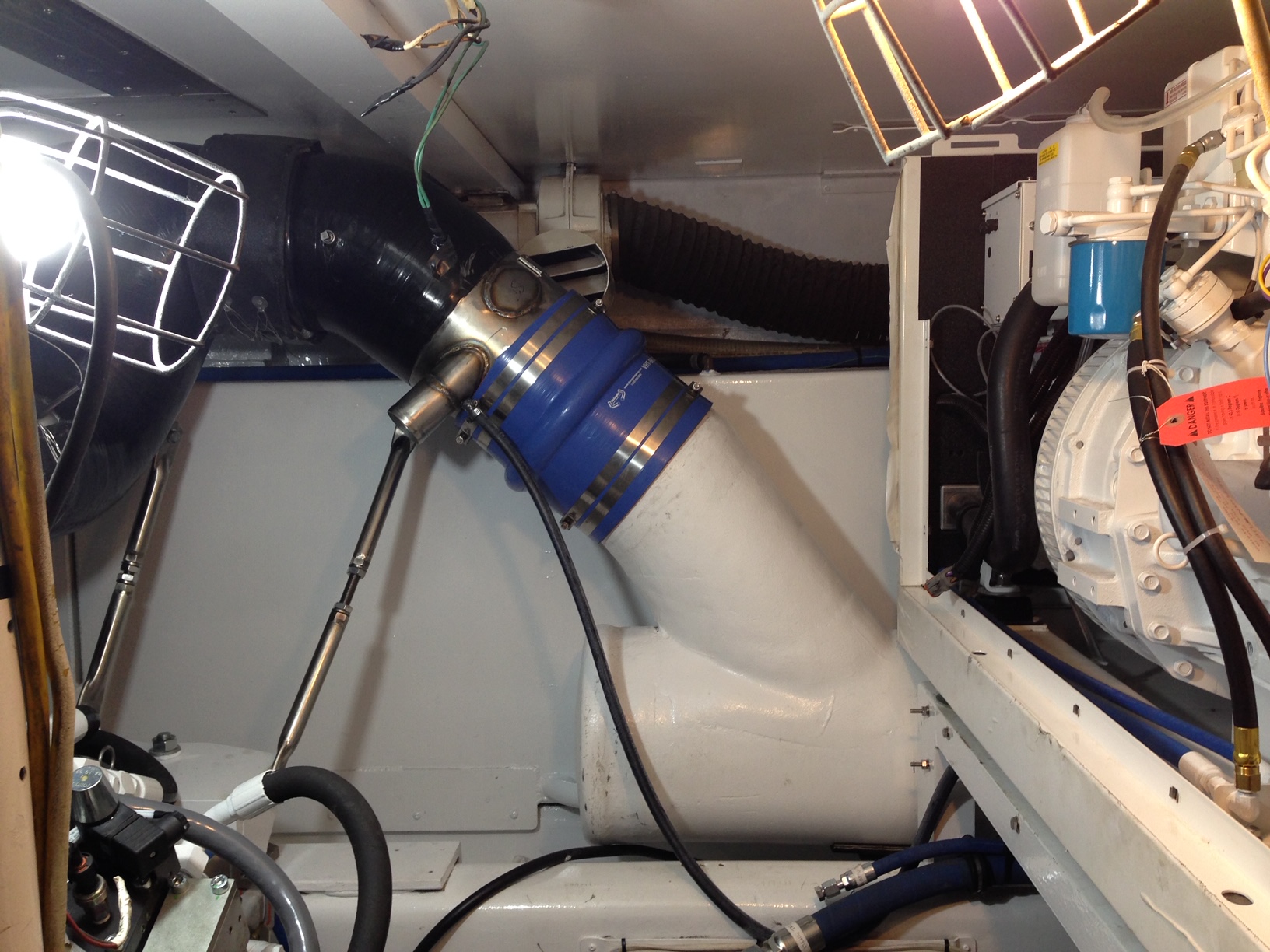

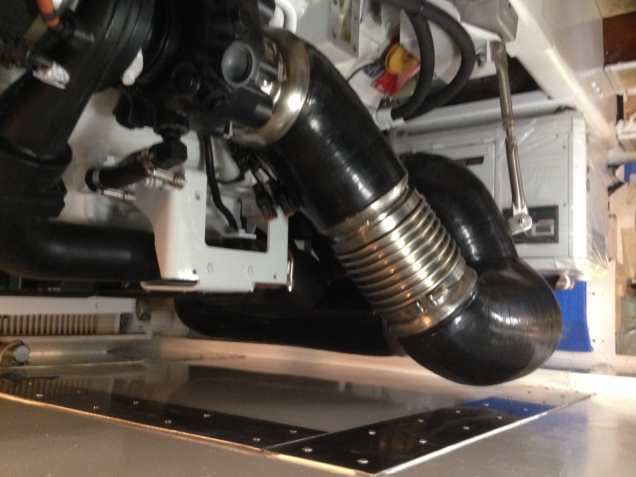

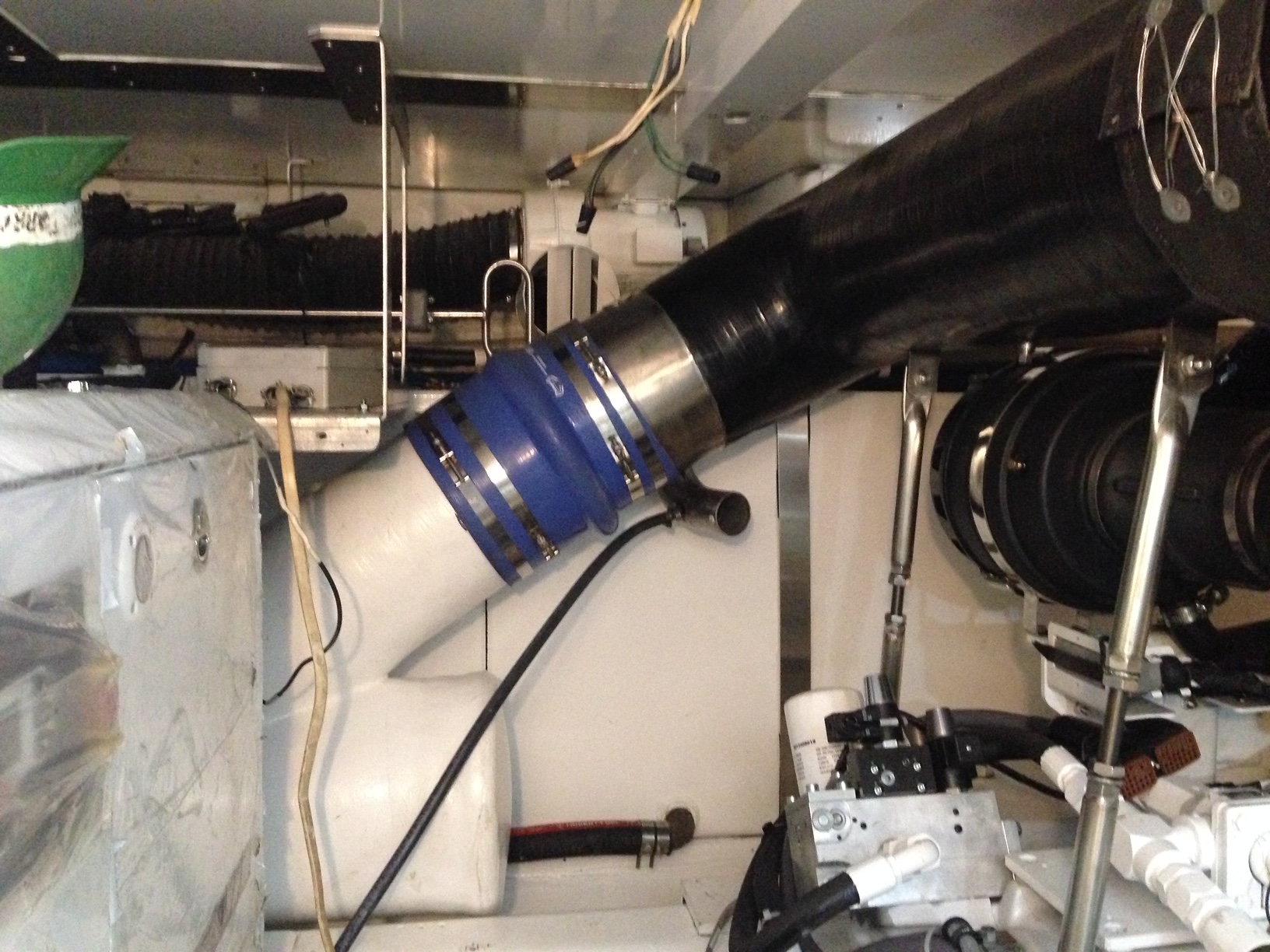

    We are getting closer every day; and every day brings issues to resolve. Exhaust is all in now-finally!. The supplier screwed up and sent us FRP surge tees that were open on both ends and they didn't include the hoses and clamps to connect the tee's to the exhaust tubes coming into the engine room. They wanted me to ship the tee's back to them and they would ship the correct one's with the dome cover on the fwd end. I told them hell no, that will take a month. I got them to air freight us the dome covers and missing hoses and clamps. We glassed the covers on the tubes and gel coated them and good to go. We also had to modify the inlet on the stbd surge tee. We screwed up when we measured as the 20kw gen was not in place then. The gen actually sits right over the top of the exhaust and the 45 degree inlet on the surge tee interfeared with the gen. We cut the FRP, mitered it to 52 degrees and moved the inlet fwd slightly. Re-glassed it all and gel coated and fits like a glove. Now that the exhaust is all in we can install the two refrigeration compressors and both Racor fuel filter assemblies and other misc stuff that was waiting on the exhaust.
    Insurance company is being a total PITA! They won't let me put the boat in the water without a survey. Surveyor asks me "how do you want me to survey out of the water with none of the equipt. commissioned and functional?". Insurance says, "just give us a survey and make whatever notes surveyor deems necessary." ARGH! It's getting done but what a waste of time and $$. Guarantee they will make me survey again once everything is done and commissioned. Ironically, this is the same underwriter that carriers all of our shipyard business policies. I asked them why they are OK with us putting billion dollar Navy destroyers back in the water without a "survey" but they somehow have determined this 54' boat is a high risk and we suddenly are a bunch of idiots that don't know how to do this type of work? They had no answer.
    Headliner is progressing and carpet being ripped out up forward and new starting to go in. Still have lots of misc electrical and finish work to do. Splash still scheduled for 6/2. CAT is scheduled for initial start -up and trials starting 6/8. This gives us several days to get the new gens, steering, watermaker, etc tested and everything else back on the line.

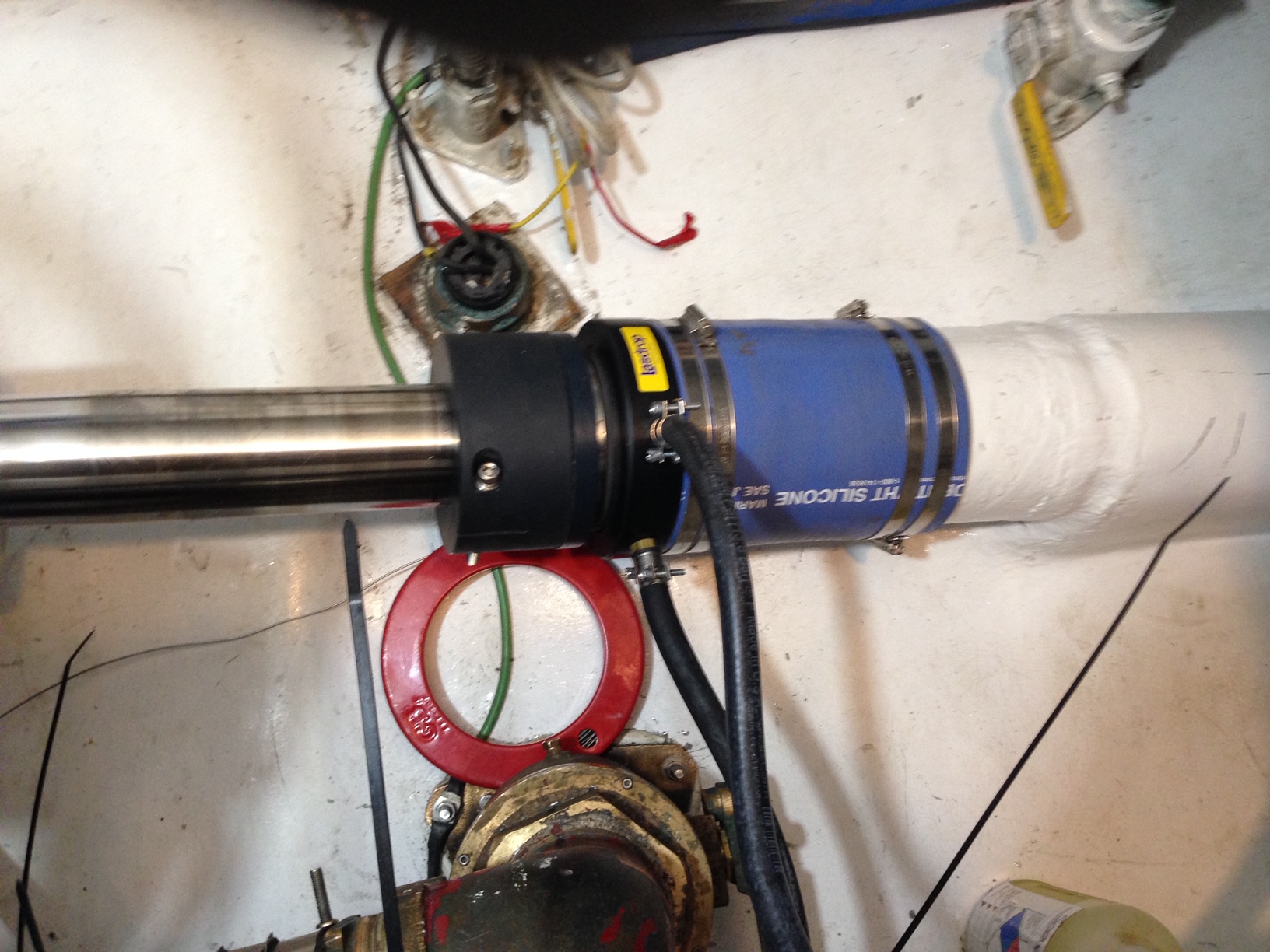

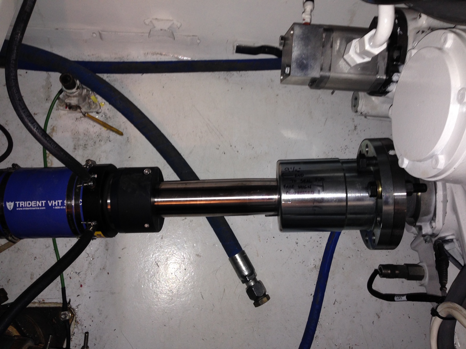

    For those of you who like pictures. Exhaust is now complete (2.5" raw water discharge hose still remaining), shaft seals done. And the surveyor didn't like plastic strainers on the intakes in the Laz feeding 9kw gen and raw water washdwon. Replaced with bronze strainers.

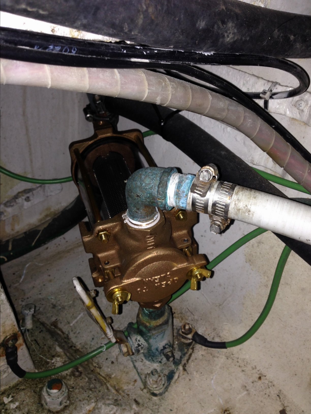

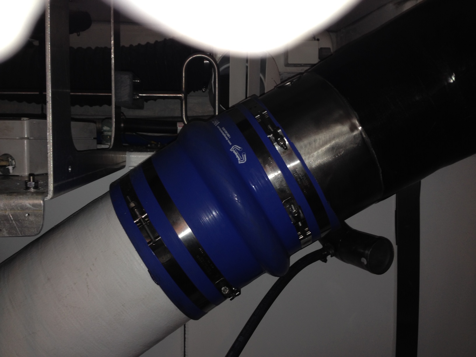

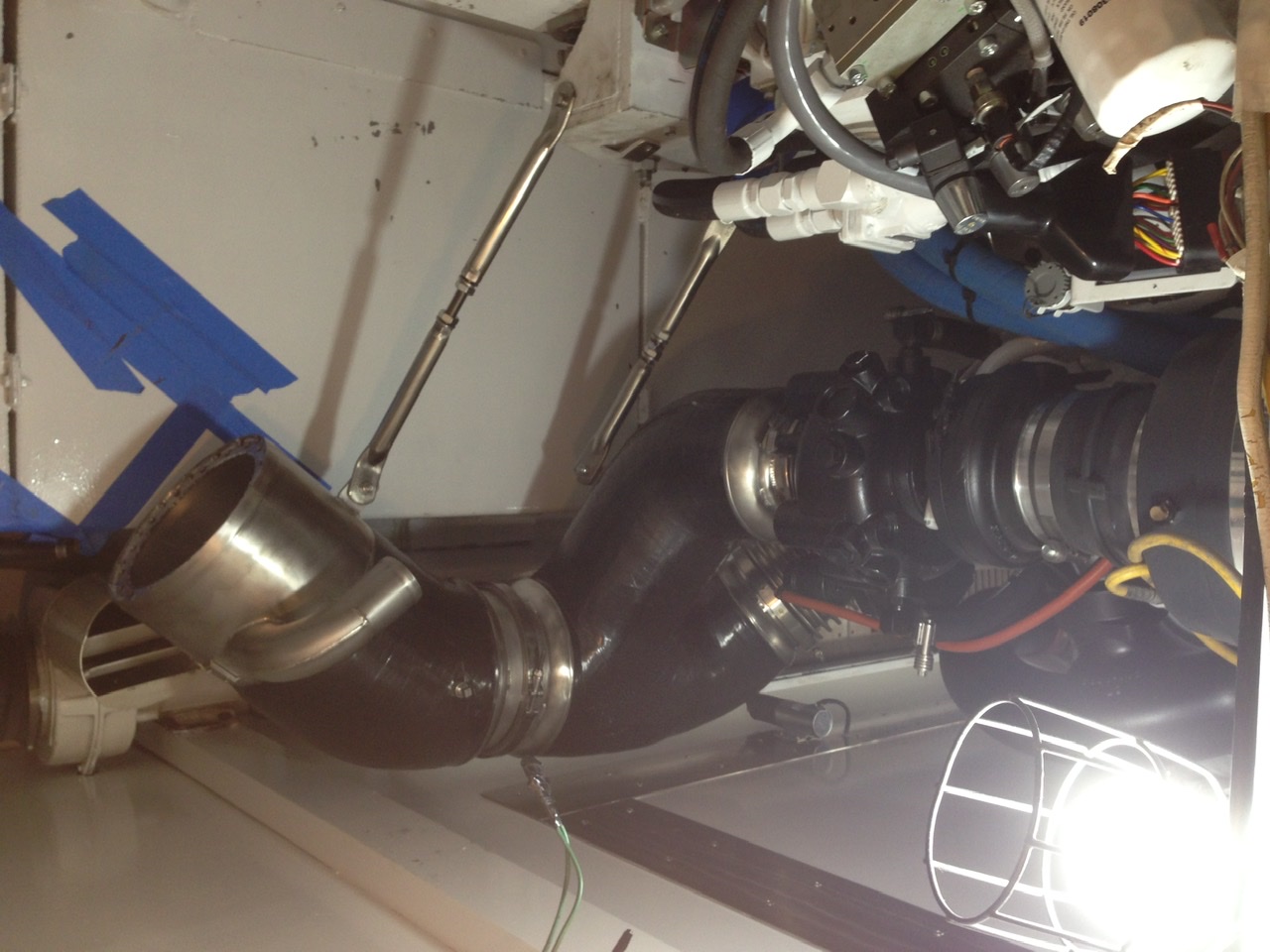

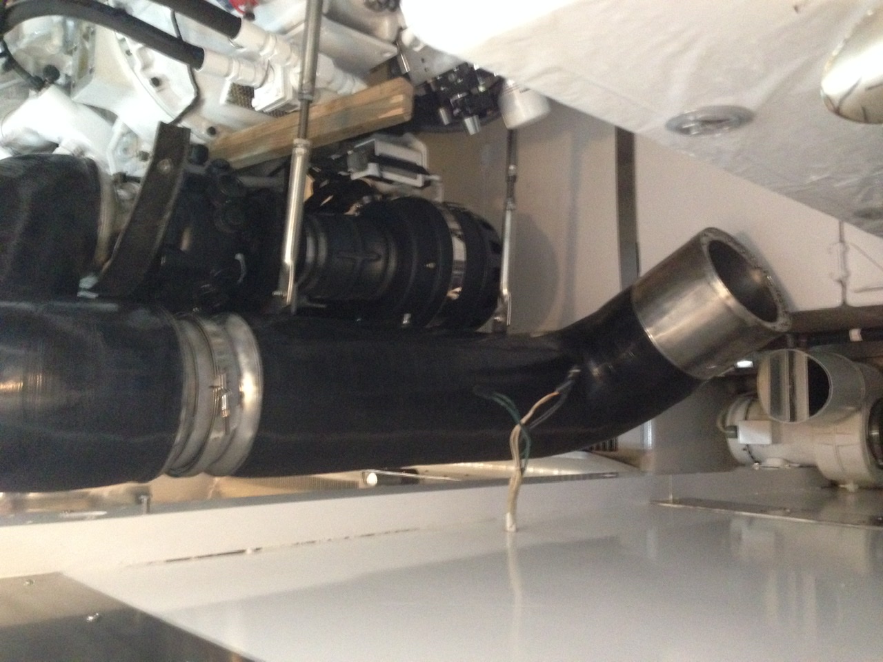

    more pics....
