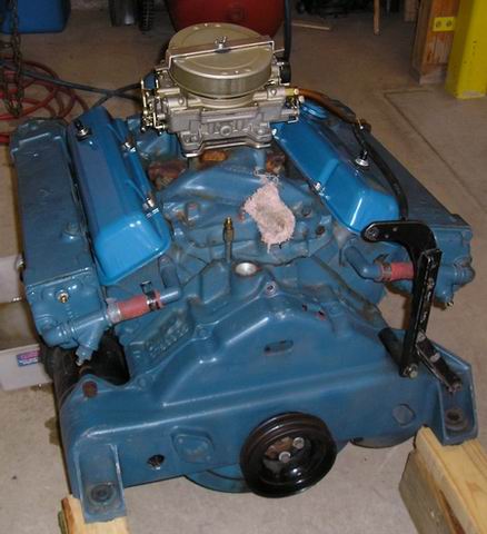

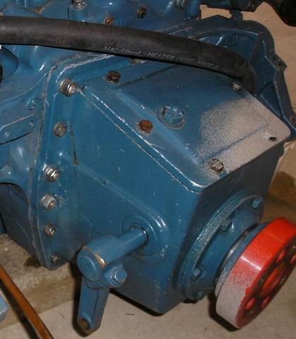

    Roamer
    If your engines are in a 1962 roamer 27', I would think they are identical 283 C.C., to mine. The problem is they are sitting in backwards, flywheel forward and the transmission is driven off of the front of the engine where the harmonic dampner should be, also the lube for the trans is fed through the crank shaft and is engine oil. Usually what takes the motor out is something wrong with the trans. The trans are a C.C. converted Paragon. Also if you post this on the engine section of the "Roamer Forum" farther down the page, you might find others that have already done all this and are more familiar with your boat design.
