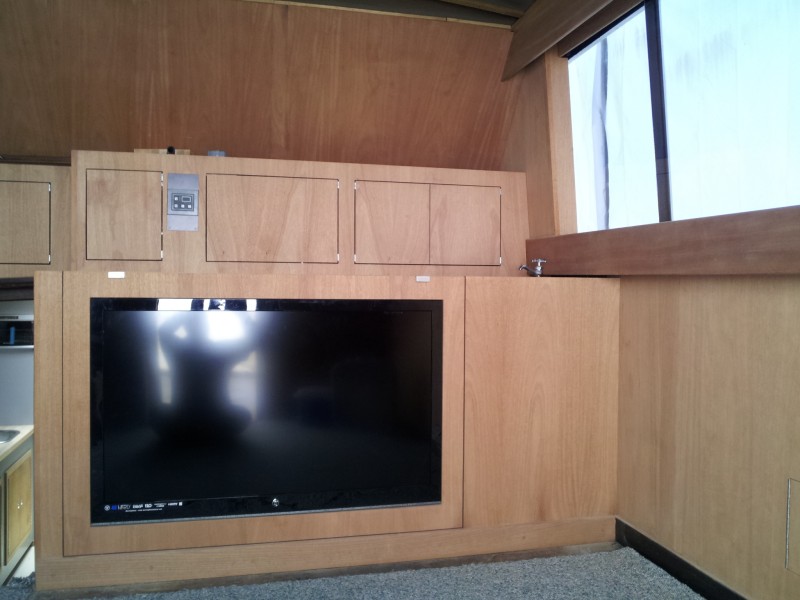

  12. P46-Curaçao
    P46-Curaçao Senior Member
    Mar 8, 2013
    734
    I'm in Ft Lauderdale from Thursday and will show you my 47" LED TV Solution, I think you gonna like it! :)

  14. P46-Curaçao
    Mar 8, 2013
    734
    47" TV setup

    thats a big TV....
