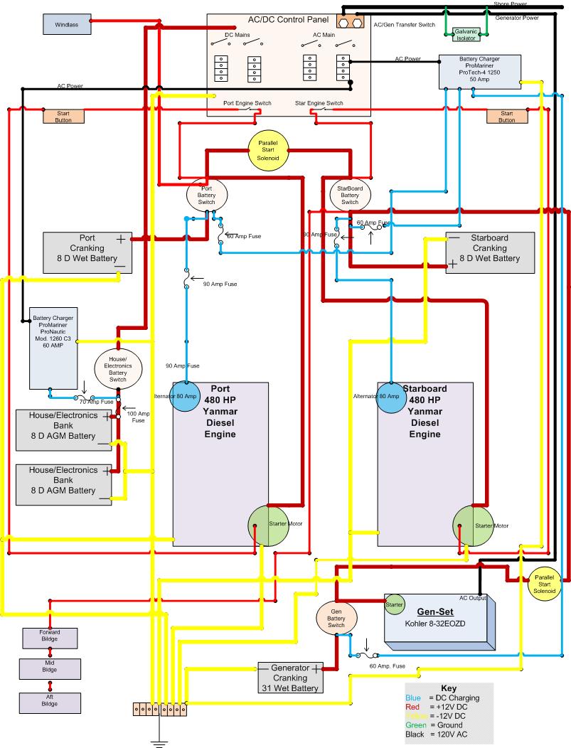

    Thanks to all on this site that helped me with the redesign of the battery/electrical systems for my 36 Luhrs. The problem with the original factory system was that the cranking and house/electronic batteries were all combined into one bank and I was often surprised with batteries too drained to crank the 480 HP diesels. I use the boat to fish 50 miles offshore, so that is an outcome that had to be addressed.
    I have redesigned the system and attached it as an Adobe .pdf. The new system was designed to function as follows:
    > Separate battery banks for main engine cranking, house/electronics and generator cranking
    > 2 parallel 8D AGM batteries for house/electronics loads with a dedicated 60 amp "smart" battery charger setup for AGMs
    > 2 separate 8D Wet batteries for cranking loads from the 480 HP Yanmars with a dedicated"smart" battery charger setup for Wet batteries
    > Utilization of a Sure Power battery isolator that allows the cranking and house/electronic battery banks to be charged simultaneously by the two main engine alternators. The diode principle will reduce the alternators' output by .6V, which is ideal for not overheating the AGMs on the 50 mile trip out and back from the fishing grounds. The Wet batteries will be compensated for when charged by the onboard battery charger cycle
    > Parallel start solenoid for the two main engine cranking batteries
    > Parallel start solenoid for the generator and main engine cranking batteries, providing extra security for the generator
    I tried to keep the redesign simple so there would be less to go wrong. I am requesting feedback from the electronic experts on the following:
    > The basic system, ways to improve it, etc.
    > Knowledge of anyone's use of the Sure Power battery isolator (2 alternators and three battery sources)
    > How to disconnect my Hitachi, internally regulated, alternators' power output and connect it to the battery isolator. Is it as simple as disconnecting the battery wire from the battery terminal on the back of the alternator and connecting this wire to one of the output terminals on the isolator, and running a new wire from the charge input post of the isolator to the battery terminal on the back of the alternator? I have read that some other functions like tach output, etc. rely on the alternator charging function.
    Thanks again for all the help,
    Carl

    Added PDF File
    Adding PDF attachment for the post above

    Warning! Not All Alternators or Battery Chargers Work With Battery Isolators!
    I spoke with Gary Felipe of Sure Power and learned that my Hitachi alternators would not work with their battery isolators. He said, "For an alternator to work, it needs a separate battery sensor wire that connects directly to the battery." Gary went on to say that "Battery chargers are a little different and vary by make. Some have adjustable regulator settings to compensate for diode drop etc. Some do not work at all with battery isolators and need to see the battery directly in order for them to even turn on."
    This being said, I have been forced to rethink my alternator charging scheme. The simplest redesign to my system is to have each alternator charge its own starting battery and eliminate the battery isolator subsystem. The new ProNautic charger, that I recently purchased, is totally dedicated to the house AGM batteries and cranks out 60 Amps. The only time that the alternators would have been helpful to the house battery bank would have been on the ride back in after a day of fishing. Now that I have been forced in this direction, I think that they will be charged just fine by the onboard battery charger, which is activated by the Genset which is cranked up and running during the return trip and with onshore power once I get to the dock.
    I have attached the redesigned system. What are your thoughts or maybe other solutions?
  19. Capt J
    14,805
    The Pronautic charger only puts out 60 amps if you bridge the 3 leads together.
    Could you run the isolator between starting battery bank and the house battery bank, and run the alternator straight to the starting batteries.......
    I had a friend now come to think of it that hooked his yamaha EFI 200 to an isolator and then 2 battery banks and it made the engine run weird.

    Gary Felipe was talking about his dual alternator to 3 battery output, Sure Power battery isolator. The Hitachi alternator will work with a battery combiner.
    There are three reasons for not using a battery combiner for charging the Cranking Battery Bank with the House/Electronics Battery bank:
    > I plan to use Wet or Flooded 8D Deka batteries for the cranking function and AGM 8D Deka batteries for the house/electronics loads. The battery manufacturer advises against charging dissimilar battery types together.
    > I have dedicated an onboard ProMariner ProTech-4 battery charger with a specific Wet/Flooded charging pattern to charge the cranking battery bank and the new ProMariner ProNautic smart battery charger with a specific AGM charging pattern to charge the house/electronics battery bank. If I were to combine these two banks, it would defeat the separate charging programs.
    > The cranking battery bank's discharge will be minor and require only maintenance levels of charging. The house/electronics battery bank will be exposed to heavy, long term loads (if the fish are biting) and require heavy and long charging. This can be most effectively performed by two separate charging systems.
