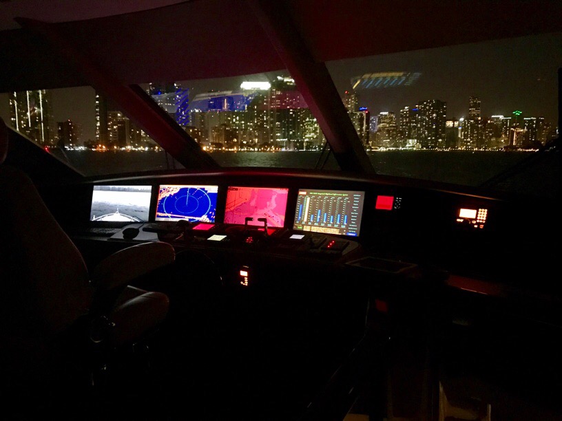

    It was was beyond repair as they were not very waterproof. The new one came with a waterproof enclosure which I was able to mount inside the ceiling
    So I ended up pulling the camera system off the Navnet and setting it up on a PC. I had just installed an extra monitor at the helm dedicated to the FLIR so I just added a cheap PC and set up the Axis software. As a bonus I can now set it up for motion detection, remote monitoring etc
    Just frustrated about Furuno dropping camera support altogether
    Also because the boat is a skylounge and the helm has a overhang I was happily surprised that a standard HP 20" monitor is very readable even during the day. Big saving over the marine daylight readable monitors
    Here is a night time shot of the helm with Miami skyline in the background IMG_5107.JPG
  4. Capt Ralph
    12,741
    Gad, I miss Miami at night.
    When I worked for Sea Tow KB, the back glare was welcome/curse running down to the feather beds & Black Point.
    Yep, FurNo has dropped the ball on a lot of options and caused lots of aggravation.
    I like your work around and the idea it may be more usable with cheap options.
