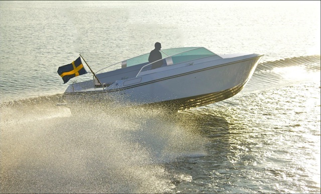

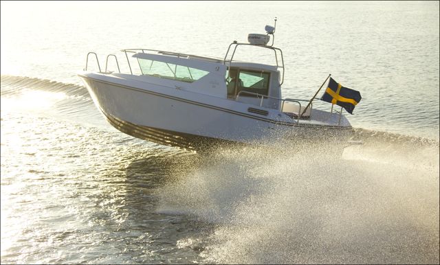

  7. AMG
    5,386
    This is the way I made a rendering, I actually kept the hull as well, to get our D29 Sidewalk to become a Runabout...
