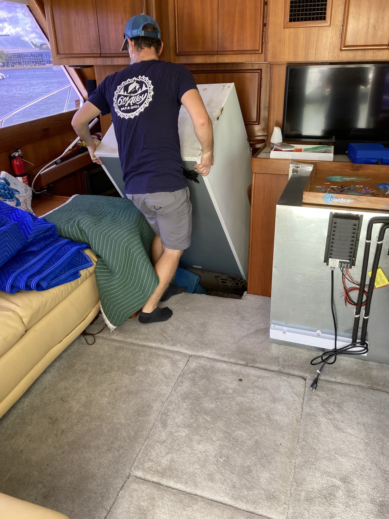

  9. chesapeake46
    chesapeake46 Senior Member
    Jul 26, 2009
    1,781
    1980, galley down, fridge in the center of the companionable, opposite the galley.
    It was as wide as a standard unit but about 3 inches shorter.
    Removed the doors. Covered the end cabinet with movers blanket and one of the dock hands and I carried it out. Very carefully.
    Hardest part is getting a good grip

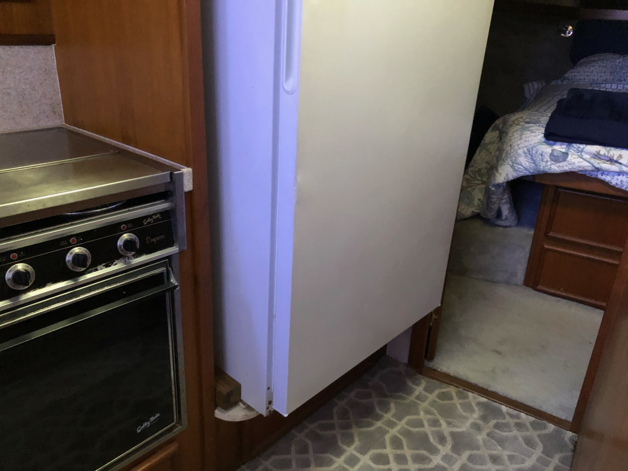

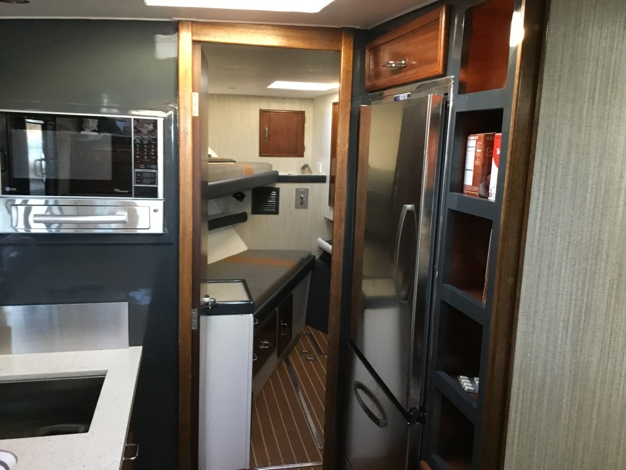

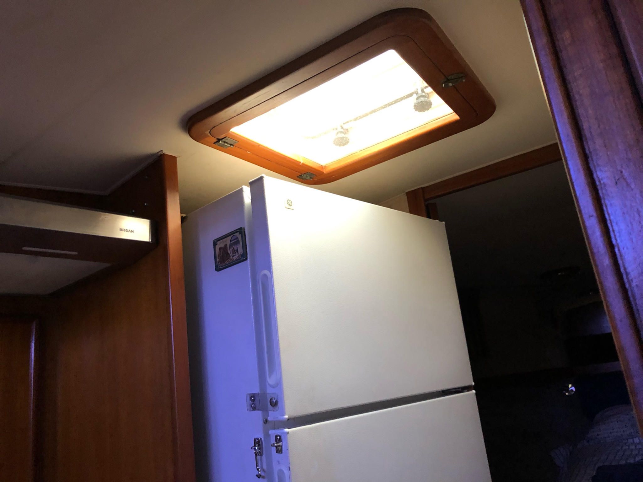

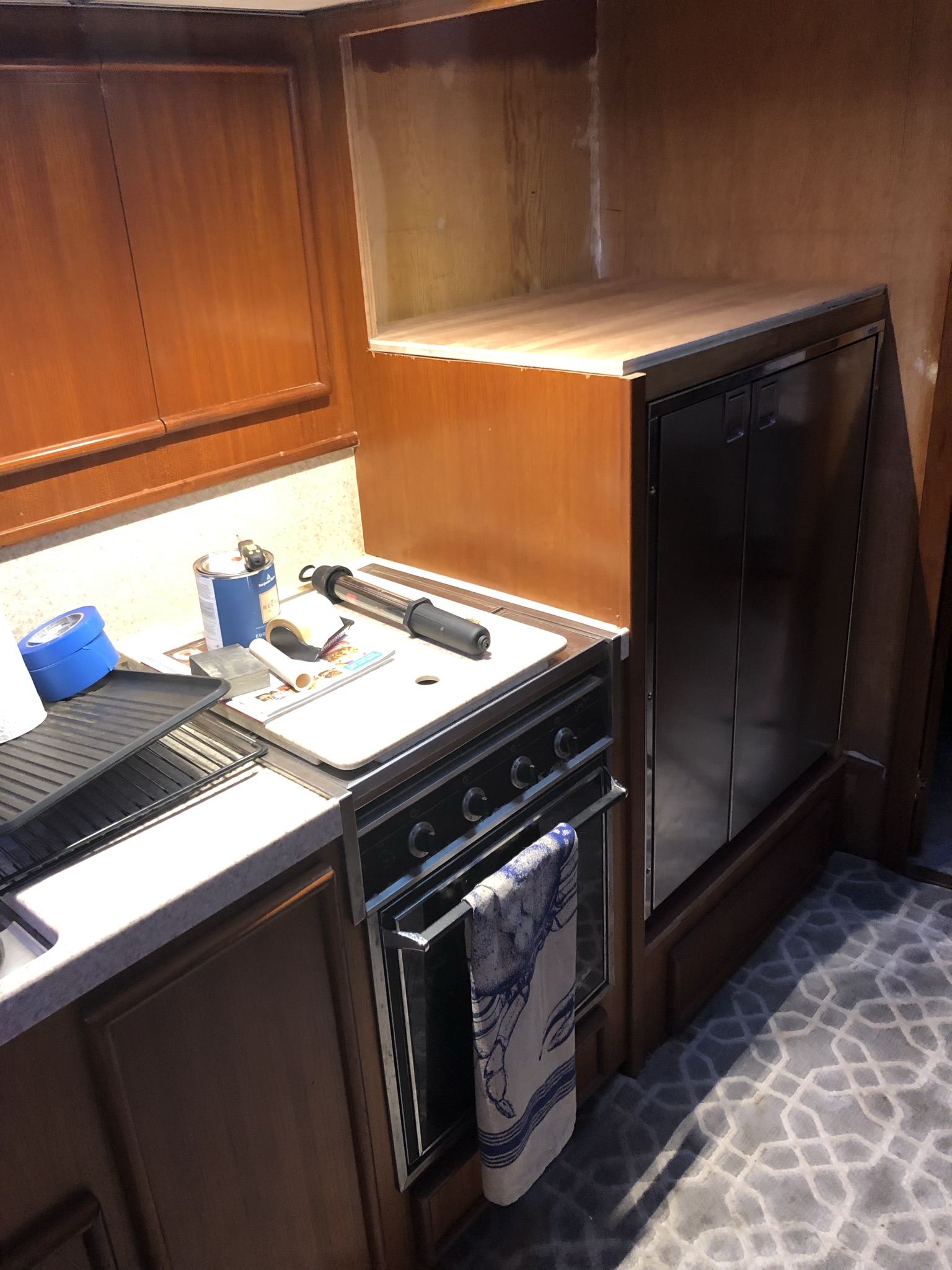

    Thanks for the pics. Ours is similar except the fridge is on the galley side of the hallway. It should be 26" x 28" with the doors off, so I think will slip between the breaker panel cabinet and the overhead, but is more than I can lift (even with my nephew helping). We are going to put in a Cruise 200 and use the extra vertical space for more storage and counter space.
    -Greg

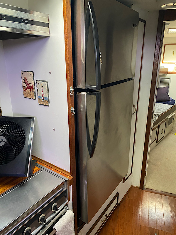

  11. OutPost
    OutPost Member
    Jul 26, 2016
    73
    Long Island, New York
    Here’s mine a few extra inches deeper after raising it up and chopping out some stuff in the hole.

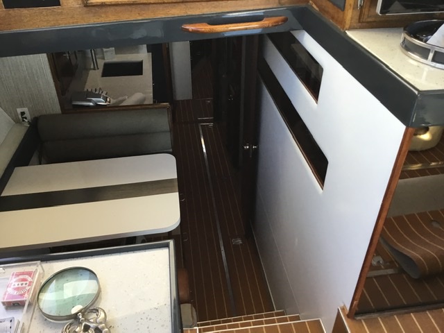

    Old fridge was out in 20 minutes with two strong yard workers. New fridge is in, still working finish moldings (finding teak moldings in stock has been a challange). Also need to add new false back wall to line up with the wall in the rest of the galley, and provide the ventilation duct for the refrigerator cooling air to exit at the ceiling.
