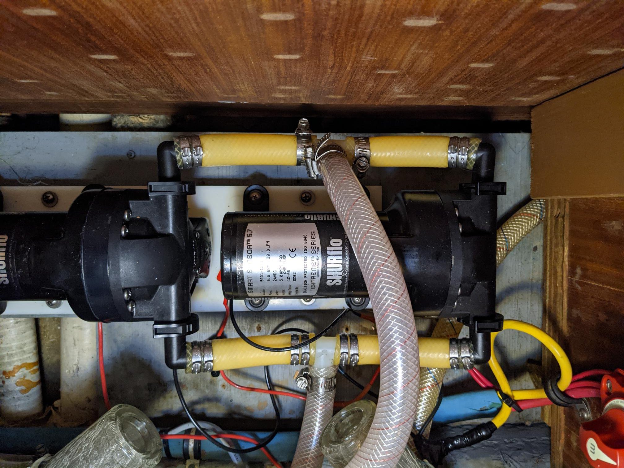

  7. Eddieclemons
    Eddieclemons Member
    Jul 22, 2019
    48
    Nashville, Tn
  8. Pascal
    8,162
    Eddieclemons likes this.
