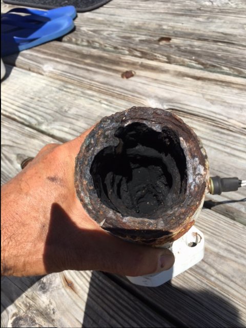

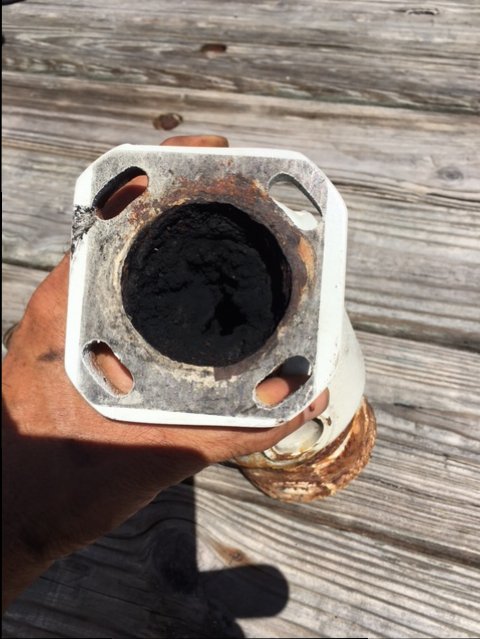

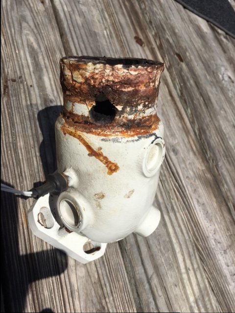

    I haven't looked how to change the pump seals because a new pump is relatively cheap and they tend to last for many years. Let it be known as well that the stock impeller has 12 blades; there is a drop in 10 blade with beefier blades that pumps more water and is a better choice IMHO. Be sure to check the exhaust elbow where the raw water is mixed in if the part is five years since replacement or has 2500+ hours on it. This one is what they end up looking like- and they don't allow the water pump to pump water...

    The gensets have 7500 hours on them. We have replaced the elbows with s/s ones. The pumps I have been told are easily rebuilt I just have not figured it out yet. The seals come with the water pump kits.

    I haven't seen s/s elbows last any longer than the cast ones.
