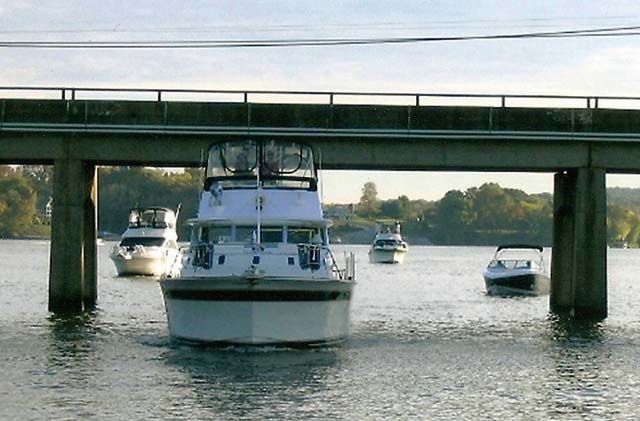

    AHHH, Just had my roamer fix. Visited my beloved Roamer this afternoon. We had a nice warm day of 65 degrees and crawled around the bilge to check out my rudders. I think the answer to my problem is to pull her out of the water, remove the rudder and go from there. Just sitting on the aft deck makes me "recharge my batteries." A young couple walked past my boat on there way to meet a boat broker who was going to show them a Sea Ray. The cute girl stopped next to my boat, pointed to the Roamer and said to her husband, "now this is a real boat!!" Made me feel good. Great Day!!!
