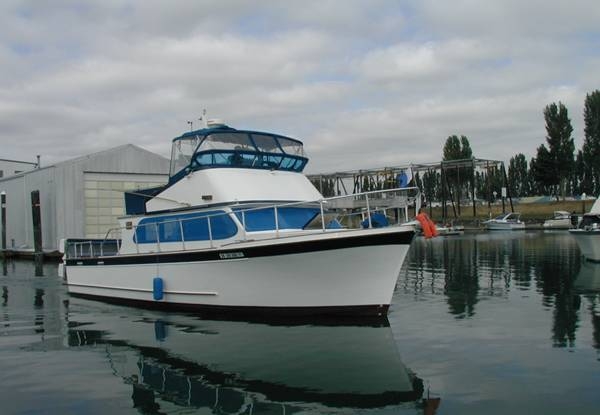

    Let's see if I can figure out how to post a picture of the old girl.
    Well what do you know....it worked
