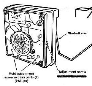

    Just put the picture with the screw here and the instructions for others that might be following this thread now or in future.
    Turning the set screw clockwise decreases the water fill. 1/2 turn = approx 20cc of water. No more than one full turn in either direction or damage to the module could occur.

    ok - I saw that screw as I was installing trying to figure out what it does. It doesn't seem to be attached to anything? I thought it was probably there to use as an insert to adjust something?
    Who know…..Its making cubes and no water when ice comes out….Will keep trying to see what I can find?

  19. Capt J
    14,435
    Thank You for this schematic. One yacht I manage has the raritan mounted sideways (not fore/aft) and sometimes depending on fuel and water load would overflow the mold assembly and create a block of ice cubes. I adjusted the small screw a half turn and it is working perfect now. Thank You.
