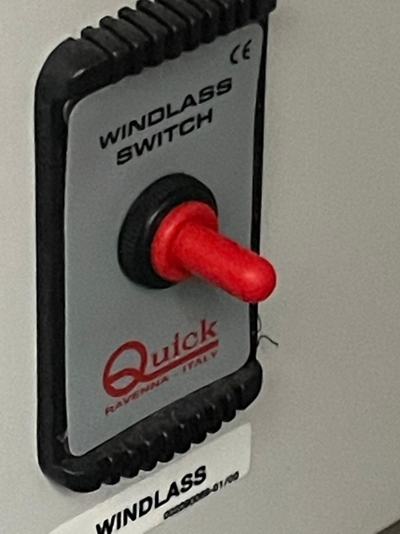

    The windlass on my 60' Azimut isn't working and I'm pretty sure the breaker is tripped. This isn't like any switch I've ever seen. Doesn't seem to do anything. Anyone have an idea on how I reset this switch? It says it can be reset manually online, but not how to do it.

    Push it in?

    Pushed it in and pulled it out. Unlike any breaker I've ever seen it's not hard. It's flexible. I was able to get the error messages of the control panel, but still can't get the windlass to operate. Just had it surveyed for the sale and it was working then. Thanks.

    Then time to measure the back leads with a VOM to ensure that is where the failure is.
    Look for a battery switch somewhere while looking for your Volt-Ohm-Meter.
    Purchase surveyor may have turned it off the battery switch.
    To be usually off until used.

    Depending on how strongly you did that, I'm afraid you might have broken it.
    In fact, it's supposed to be either lifted (ON position) or lowered (OFF position).
    It's impossible to be positive about its current position just from your photo, but if I should guess I'd rather say it's off.

    Actually it is a normal breaker, and also pretty solid.
    In fact, coming to think of it, I never came across one that failed.
    So, it might well have withstood the push/pull attempts... :)

    Then lets find the battery switch to the breaker and windlass turn it on or On-Full-Force (OFF) and check the breaker.

    Just for reference, as I said the switch itself is the breaker, meant to connect/disconnect the positive DC power cable going directly to the windlass.
