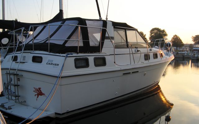

    Older Carver's
    Last summer we purchased a '85 Carver Riviera. 28' with twin crusaders. Very well maintained. We are the 3rd owner, first had it for 17 years and loved the boat dearly. The 2nd owner just kept it at the marina and didn't use it. After a thorough survey, weeks of cleaning - we are very proud of her. Solid boat for a 28 footer.

    Thanks for reaching-out. We loved our Riveria and occasionally discuss how much we enjoyed the boat. When first purchased, the survey returned a single page of recommended items, all cleared-up within a weekend. Very little was noted, and nothing structural. Very solid boat, easy to handle and a breeze to dock. While not as fast as a 30 Sundancer, she was easily as stable and had twice as much 'livable' room aboard. Fuel consumption is relative, but I ran her at 17 - 18 knots and averaged about 20 gph at that speed on Lake Michigan. I could keep her on plane at as little as 15 knots before she fell-off. One downside to note - she's not a 'dry boat', the bow doesn't have enough flare to keep all the spray off the windshield, but that wasn't a problem.
