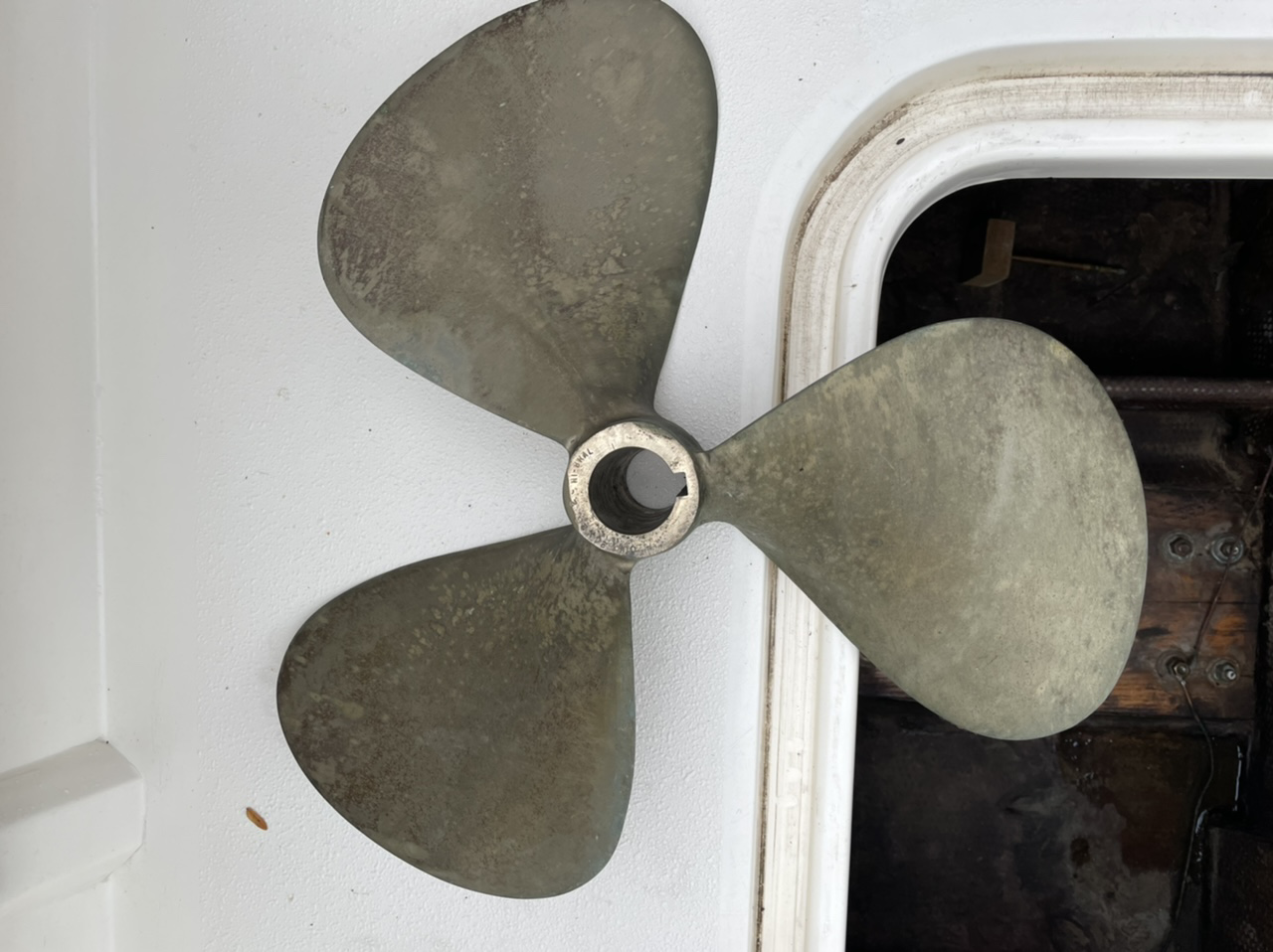

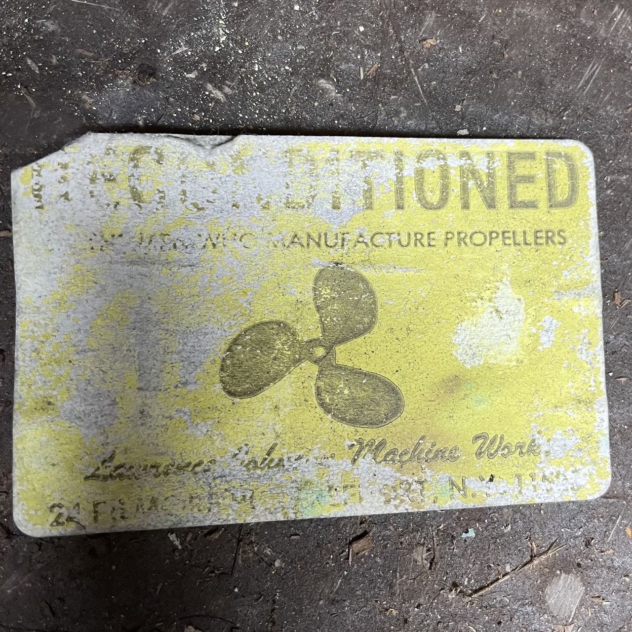

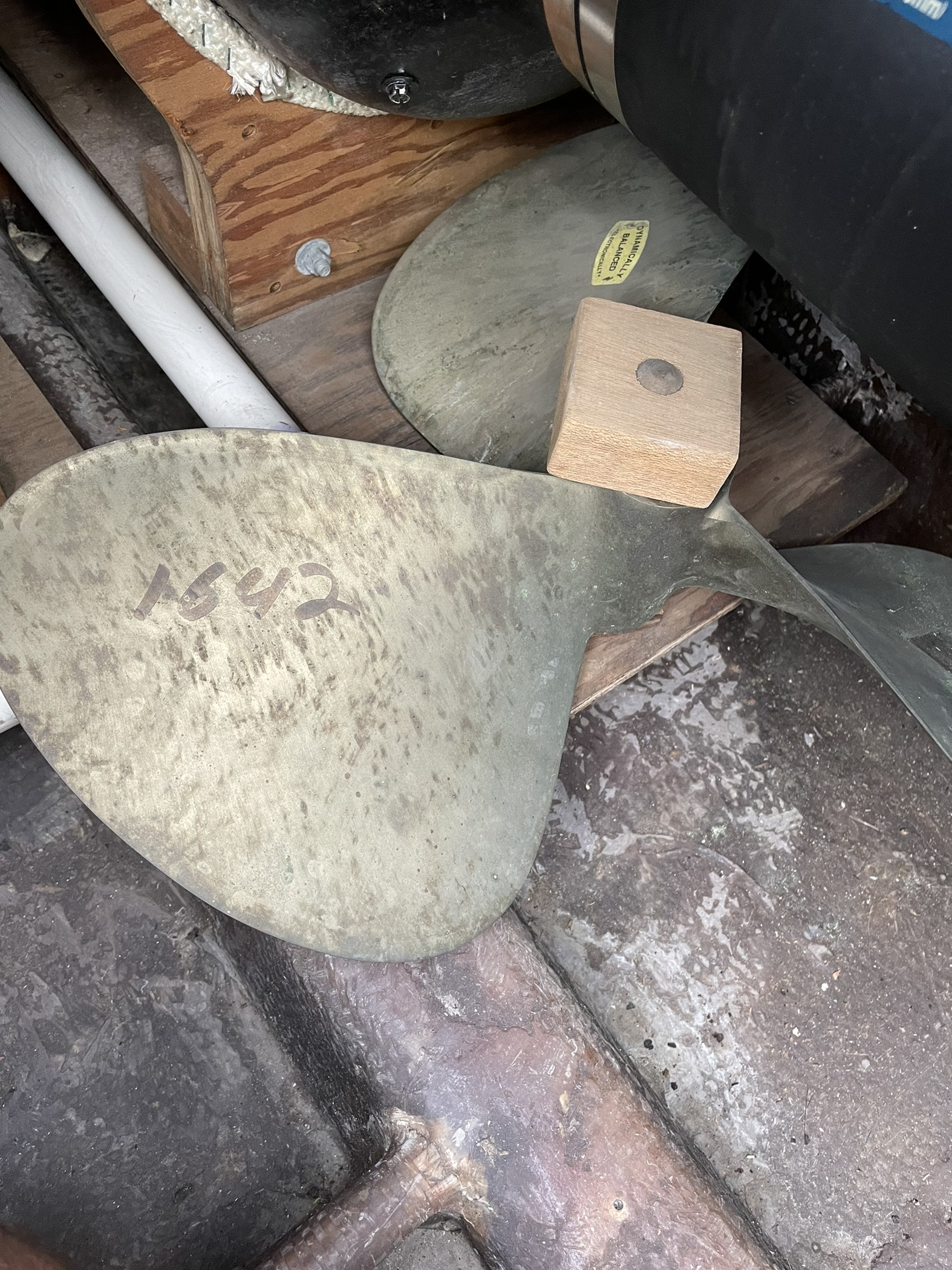

    B747FCA5-D272-4899-8630-F7C71A979A1D.jpeg I was running out of daylight last night and didn't get a chance to pull the props off the bracket. Here is a photo of my starboard 3B. I can’t quite make out who serviced them. I found the “Reconditioned” sticker in the bilge that was originally attached to the aft blade. Its a shop in NY. Does anyone know what the “1642” stands for or who reconditioned the wheels? CFB290C2-5B70-4FB2-B491-80BF2867A446.jpeg

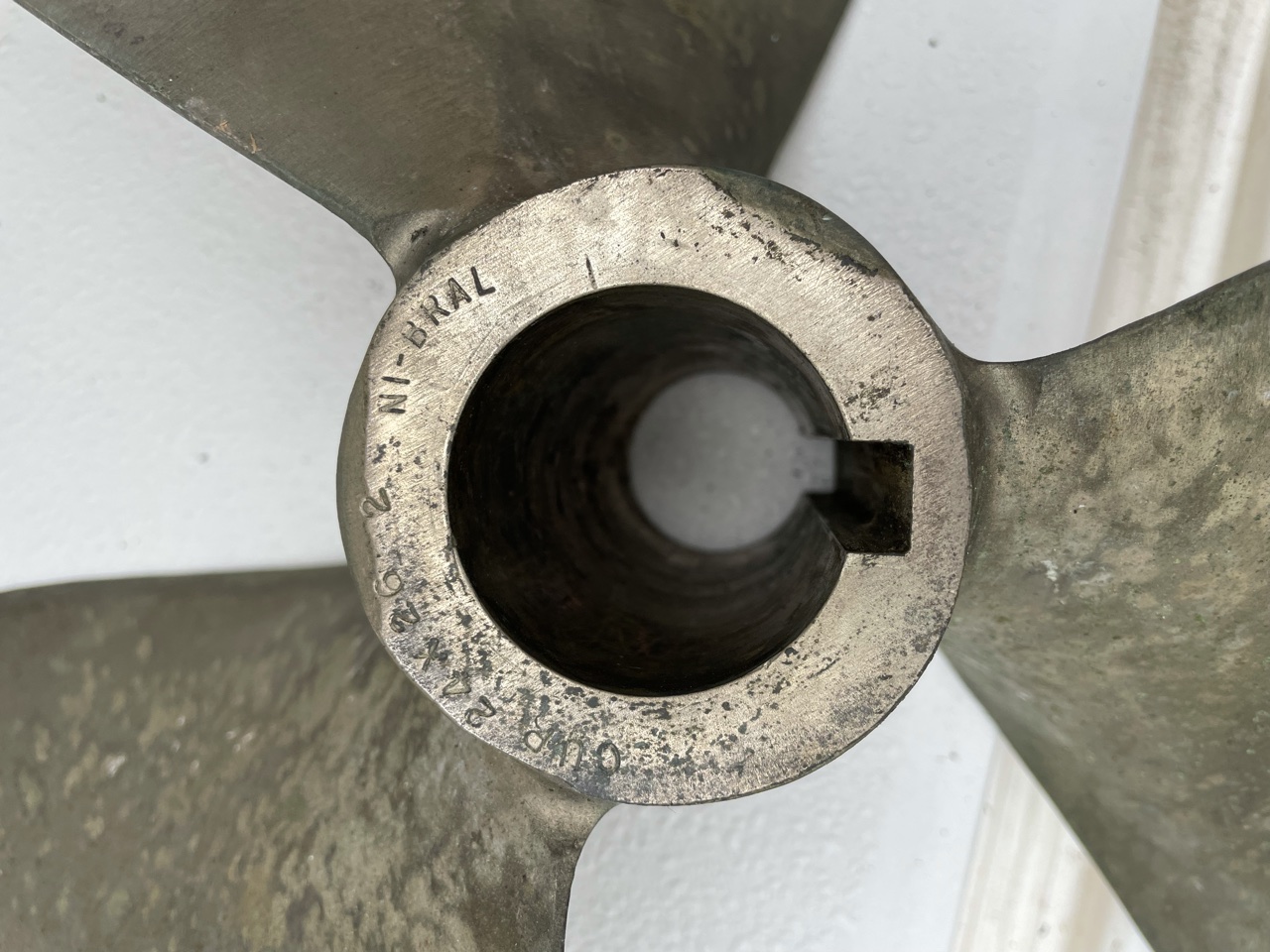

    Thank you. The numbers would be on the hub between blades. All good, thanks for checking. I don't think that 1642 means anything related to size of prop.
  9. Tight Lines
    Tight Lines Member
    Jul 17, 2021
    42
    Grand Rapids, MI
    Agreed. That was probably a ticket or work order number that the shop used. I’ll get the information off the hubs tomorrow or Wednesday.
  10. Stainless45
    Stainless45 Active Member
    Jul 19, 2019
    167
    Post 46 Long Island NY
    T
    That sticker is from Lawrence Johnson Machine works, a propellor shop near me in Freeport NY

    CUP 24 x 26
    I’m willing to bet that these are original.
    Reel Antsy likes this.
