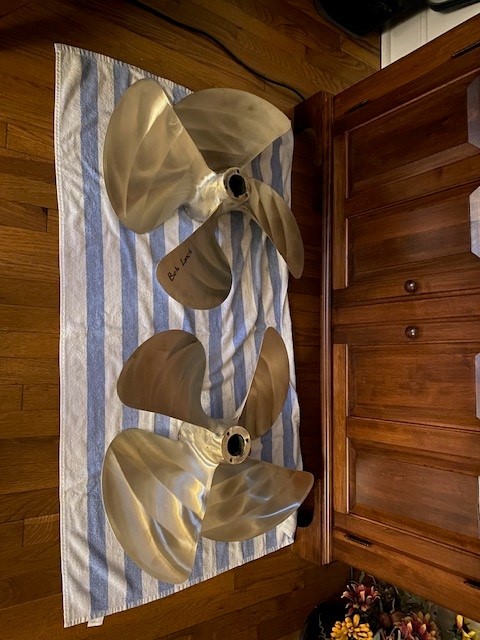

    I am going to be applying prop speed to the shafts, struts and props on my 40 Cabo convertible with C12 CATs. Trying to decide about the rudders. Any Cabo owners out there that have applied prop speed to the rudders with good results? Did the product stay adhered?

    I have not seen much of anything stay adhered to the leading edge of rudders. The yard ended up applying primer and and antifouling to the rudders so for this season Propspeed will be on the shafts, struts, and propellers only. This is my first boat with Propspeed.

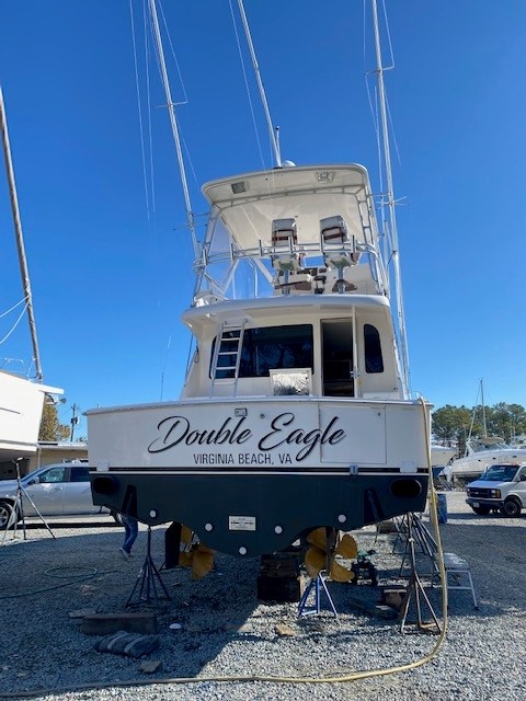

    The Cabo was launched on Friday and completed a satisfactory sea trial. I will keep an eye on the prop speed to see how well it holds up and performs.
