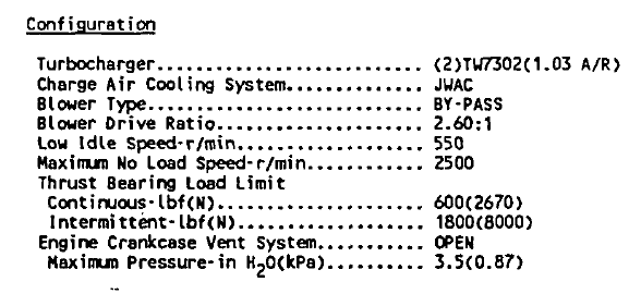

    With mechanical Detroit's you should make an effort to verify full throttle travel / correct fuel rack settings.
    At the dock, in neutral, to need to confirm that the no load (neutral) rpm on each engine is close to 2500 rpm:
    With regards to propellers - Ocean was a budget conscious builder and they could get the speeds they needed with a 3-bladed propeller for a lower cost. The good news is that propeller design has advanced considerably since 1992 and you have good options in the new Michigan Wheel product as well as ZF, Acme and a few others. After verifying the engine makes power (has the right compression), the fuel rack is correct, you have the right throttle travel, etc., you can approach a good prop shop and they will be able to help you.
    There are ways to get additional stern lift through cupping, but this takes some trial and error and can get expensive if they are not close on the first try. Some of the better shops like General Propeller and Frank & Jimmies know the cupping tricks, make sure you get a cup spec by the number, instead of vague words such as "light, medium, heavy". Get cups done with gages, they are usually numbered #1 thru #10 (lightest to heaviest).
    You can easily take out 2" of Pitch on your current props and then add some cup back into the equation to get to a correct spec full throttle rpm of 2300 - 2350 at full load.

    PacBlue is correct.
    Making sure the racks roll wide open without binding and the governors are set correctly.
    No-load, WOT for a few seconds will determine if there is a governor problem. No-load, high idle should be around 2500-2550 rpm.

    Those are all good points. No load on starboard was 2550 but port only turned 2400. When I get her back over to St Pete I will get her tuned to make sure I have her making full power before making any other changes. Thanks for sharing all of your expertise!

    Sometimes your throttle cable/connection may be off a bit and need an adjustment to get full throttle travel.

    Port was slow under load? You just found that problem. It takes both engines to find loaded max rpm. Full load of fuel, bunch of folk and excess stuff can hurt also.

    Yes under load it only turned up to 2126 and Starboard turned up to 2258 under load which props would certainly fix starboard but port obviously needs some work.
  15. Capt J
    14,898
    If port is not making the power or rpm it is supposed to, it will also bring down the rpm's on the starboard as it's carrying more load than usual. Sort out the port engine first and why it is not achieving unloaded rpm's, then sea trial again.

    No load needs to be at 2500 - 2550rpm. Loaded should be around 2300 - 2350. I'm sure that is a part of your issue.
