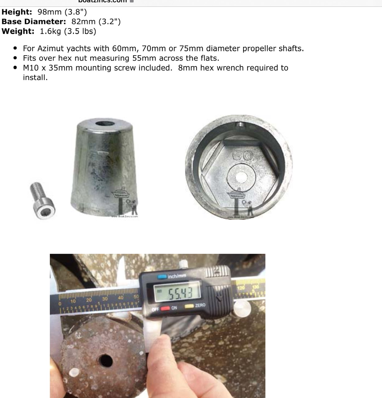

    Does anyone know what this white waxy paste is stuffed up the 60mm hex anode on the prop bolt ?
    Presume due to anti-clockwise rotation ( the wheels spin outwards ) it’s placed to stop the stud unwinding?

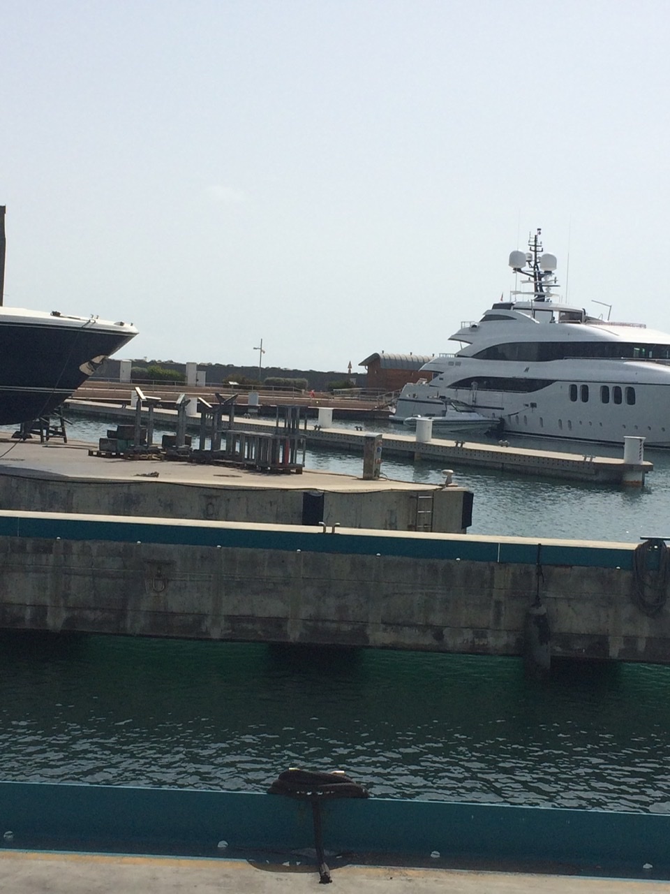

    The yard deal in mostly super yachts with normally a 600T lift .The 30 Ton crane is for small fry .So have they or are they bringing something from SY experience?
    Here - The yard .

    At my yard they use Sika 291, but I guess the 3M 5200 that CJ mentioned is just as good.
    AFAIK, the main reason for sealing the bolt isn't to prevent it unlocking though, but keep sea water out of the thread instead.

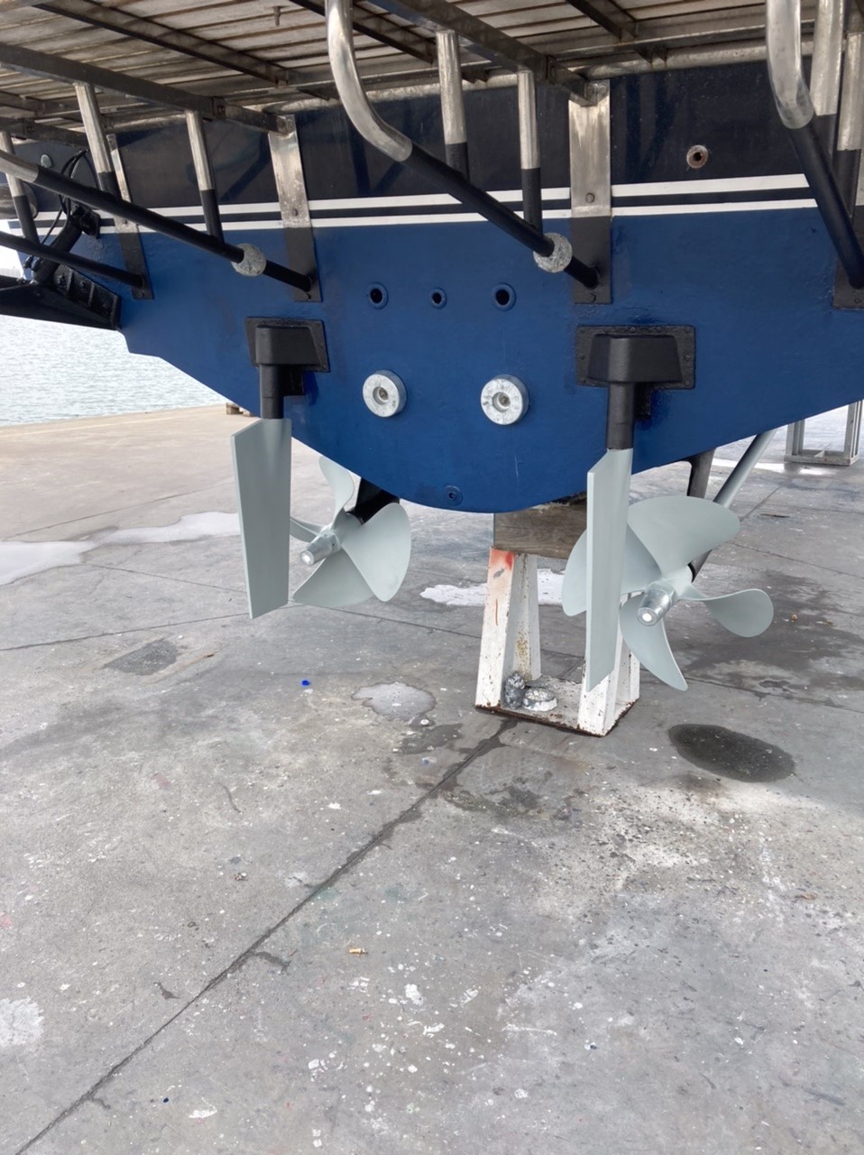

    In fact, beware: the two round transom anodes whose bolts are exposed in your photo should also be sealed.
    BTW, both producers on which I have first hand experience (Tecnoseal and FONP) supply those transom anodes with a small round cover that should be screwed into the bolt recess - after filling it with sealant, anyway.

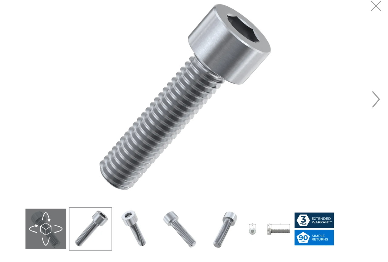

    The prop nuts are nibril or similar and the anode bolts going in S Steel .
    When I used to DIY the annual lift in France we used a blue thread lock 242 .
    Thread lock works , sets due to lack of oxygen in the tightening threads .It’s the lack of air that sets it .
    I suspect water will find it way through from the mating surface the other end , where the hex fits the prop bolt .That obviously thins down as the anode wears away anyhow.
    Transom anode .

    Starting to make sense . Now the internal hex of the anode bolt is filled .
    https://www.3m.com/3M/en_US/p/d/b40066996/

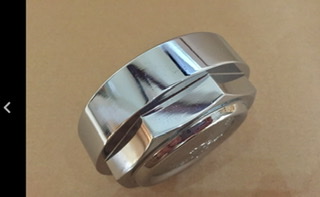

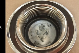

    I post theses pic based on my experience with a 86 Testarossa back in the day .
    0D0D7765-9E03-49DE-B3E1-94D693D06398.jpeg C0FB5A72-EDEC-426F-82DB-07EBC9640285.jpeg AE8D823E-6FE5-4740-B861-15B7FE106E25.jpeg
    Borriani single wheel nuts .
    Exactly the same issue ……well could be in theory but Ferrari reverse threaded one side the left ,so in forward motion ALL four always tightened as you went forwards.
    You don’t want to pull up to lights and find a wheel ( one of yours ) passing you !
    So based on that why not reverse thread the port anti clockwise prop nut ? Only the anode retaining hole not the lock bolted main ( prop to shaft ) bit .
