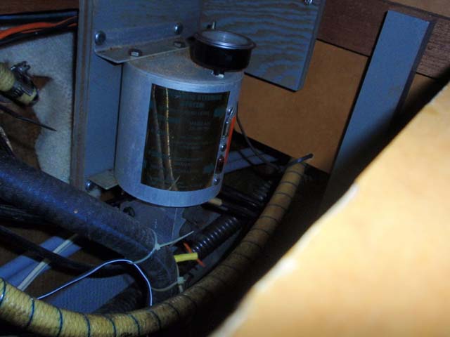

    Whilst digging around in the boat, I ran across a power steering oil reservoir that is about half full (empty?). I'd like to see this completely full. Any know what sort of oil goes in there? The stuff in there currently is a clear sort of tawny color. Think auto power steering fluid is good? What kind?
    This is on a 1983 32' ACMY

    If it's reddish coloured that will be ATF transmission fluid. If it's golden coloured it'll be a steering oil of 15 or 20 weight. That's a very broad brush stroke of a guess, is it a Glendenning system?

    Impossible to tell if you don't even know what kind of steering system you have!!! Inboard? Stern drive?
    The reservoir may not need to be full so don't ASSume it should be sometimes you need room for expansion
    I'd you have inboards and the steering is Hynautics it uses a Gold colored hydraulic fluid available at most marine places although ATF can be used as well. Check the Hynautics site for info
    If stern drives (possible on a small boat) then it depends on the manufacturer

    It's a HyNautic
    Ok, sorry for leaving out details. She's a full inboard setup with twin 350cid Crusaders. I found a manual on the system online and will try to locate oil as described in the manual.

    indeed looks like an hynautic system. it's not power steering, it's just hydraulic. Hynautic makes system with power assist for larger boats but yours is basic hydraulic.
    preferably, use hynautic fluid although it's the same as MIL Spec hydraulic fluid available from aircraft part suppliers.
    you should be able to use ATF although check your specific system requirements first. the only downsise to ATF is that steering woudl be a little stiffer.
    do NOT overfill it !!! keep it between the marks... and you need to use a bike pump to pressurize the system although i can't see the gauge on yours. all hynautics i've seen have a pressure gauge on the reservoir.
    good sytem, reliable, little maintenance

    Ummm, try reading the label on the side of the unit that is in your picture. It has all of the directions right on it.

    Yep, not power steering.
    Yep, is Hynautic hydraulic steering.
    Nope, Doesn't have directions on the side.
    Found directions though. Needs HyNautic's oil or aircraft hydraulic oil then pump it up to, I think 40 psi. Currently it is at 15 psi.
    Feeling a little sheepish and stupid for posting this though. Shoulda investigated first.

    usually about 20/25 psi is enough...

    Anything above 10 is ok......but I would stay around 20-30psi. On an older boat 40 psi might make things leak.

    Where do you put the oil. I have the same system.

    There is usually a filler hole With a plug on top of the reservoir, if not the pressure gauge could the filler hole.
