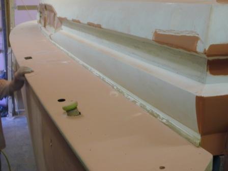

    We had the same issues! Our cause was water intrusion under the edges of the teak setting up the conditions for the corrosion. I removed all of the old adhesive from the teak and decks and then sanded down to the original aluminum. Then zinc chromate and epoxy fairing. I then had the entire repainted with Awl-Grip which was sprayed so there were no breaklines in this area for water to penetrate. Upon the re-assembly we used 3M 101 ensuring the screws were coated with teff-gel, and the total surface area of the teak was sealed in the 101. Then we re-fastend the teak and sealed the edges.
