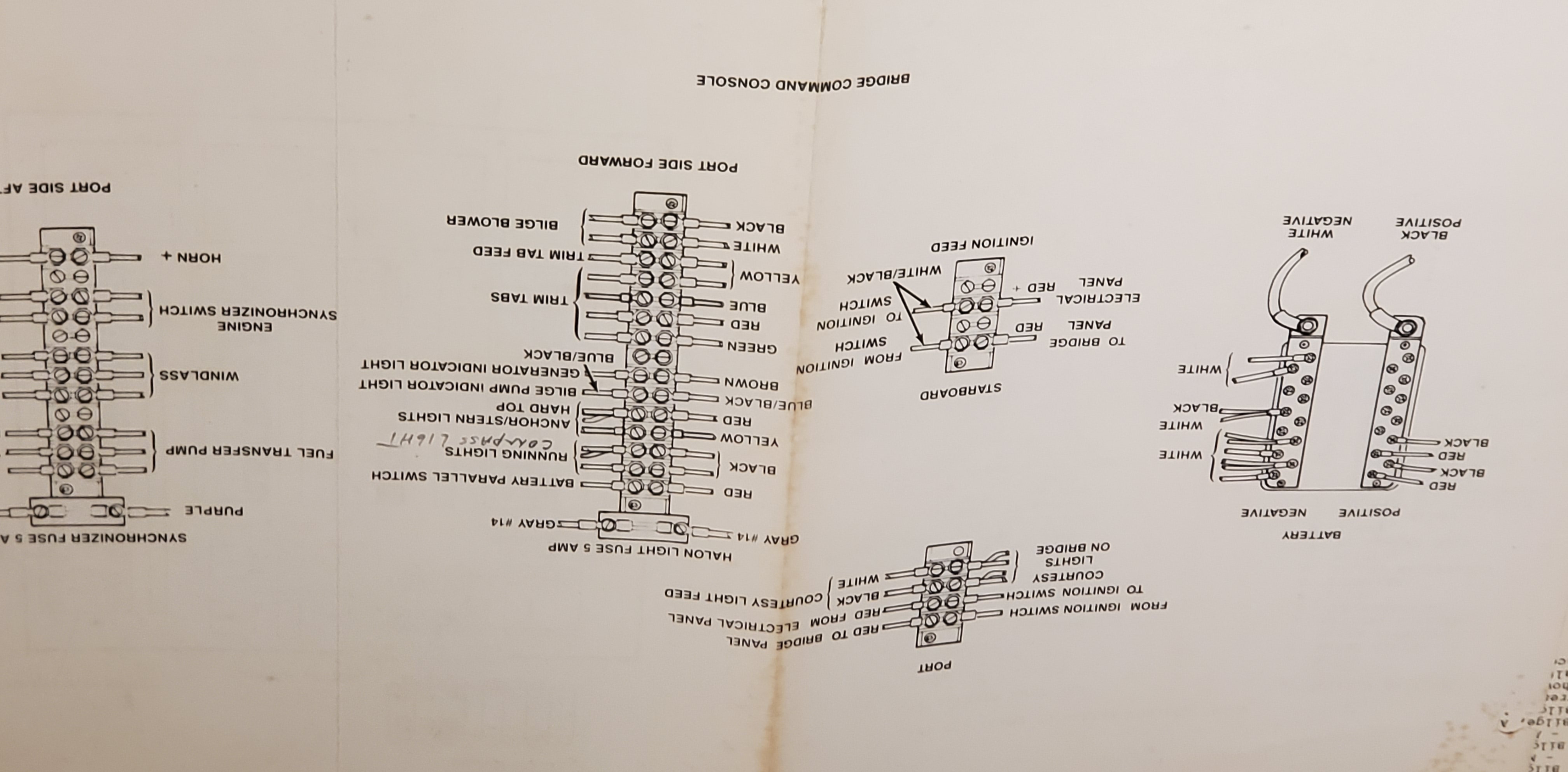

    I'm starting with tracing and removing cut but not properly terminated wiring I see and re-activating the manual bilge pump control functions. I traced the forward pump, having more difficulty verifying where the aft pump is getting it's power from.

    I could use the aft bilge pump on indicator wire color/connection at the helm.

    I missed the second page with the terminal strip assignments on my phone when I was in the bilge. That is exactly what I needed.
    BIG Thanks
