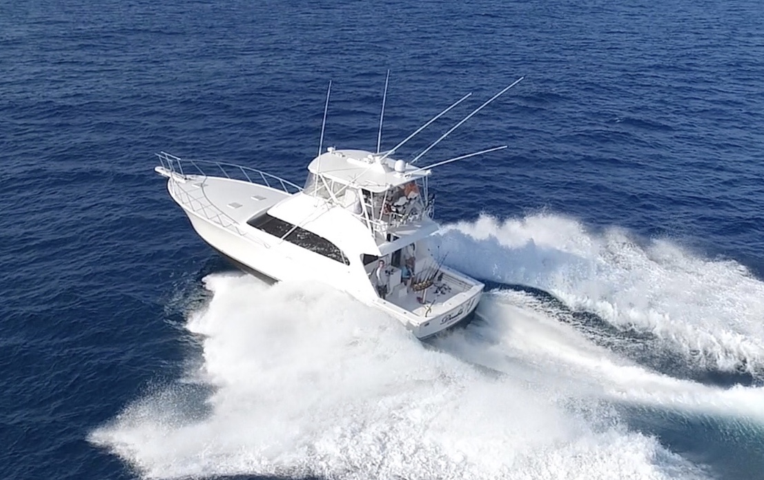

    I was asked to start a post on a Cat powered 53 so here goes.
    I believe my 07 must have been one of the last ones built before they closed. It was built for the person I bought it from with C18 acert cats at his request. Most of the 53s were built with Mans from what I understand. I have a number of friends with Mans in a variety of boats, and depending on the models, they can be great engines, although expensive to maintain, and maintenance is critical, as they are not very forgiving. Here's a photo of us running back in last weekend shot from a drone.
    I have been extremely happy with the Cats, and from what I understand, are one of the most successful Cats built.
    Also because they are inline 6s, there is a lot of space in the 53s engine room.
    They are rated at 1015 hp at 2300rpm. At 2000 which seems to be the sweet spot they push her about 29 kts burning about 80 per hour. The boat runs great, does not pound, and is fairly dry, although it's not a Carolina boat which tend to ride better and are dryer because of the wide flair. But it's accommodations, and fit and finish is top notch, and since fishing is only part of its use, I'm very happy with it.
    I'd be happy to answer any questions I can.

    Outstanding and Thank you for the update. Your ship looks great.

    Great looking boat! I have never seen a 53' in person.
