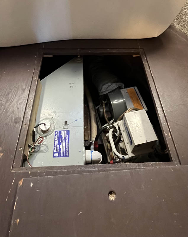

    Has anyone replaced the blackwater holding tank on a 43 (or similar) located in the dresser cabinet below the forward birth? The current tank is 29 gallons and the space is shared with the forward AC & air handler. I would love to shoehorn a bigger unit in if at all possible. Appreciate any tips/suggestions from the group.

    @Greg Page - is your MKII 43’ a forward MSTR? Both AC compressors in the engine room? Original units?
    Good call on the Elegance. I liked your write-up about the freshwater tank/tank level monitor install. If I wasn’t on the Great Lakes, I would certainly follow suit.
    Here’s a photo I grabbed today of my current config.
    @ranger58sb - was that a poly tank? What kind?

    If I could relocate the forward air compressor / air handler, I’d squeeze in a 50-60 gallon holding tank under the bed.

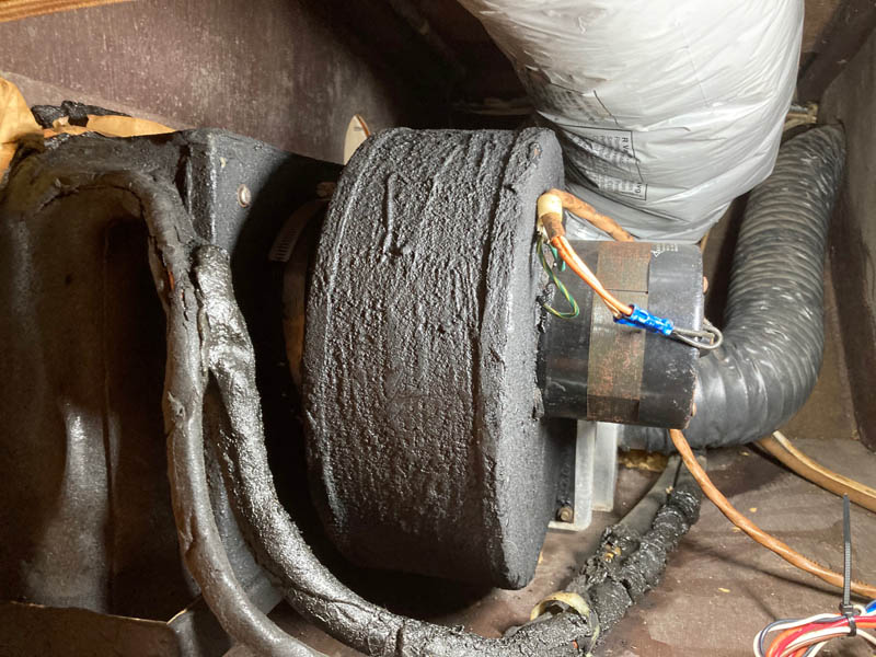

    Update with better picture of fwd air handler in top of stbd master closet (I had it open doing the AC controls replacement).
  17. boatpoor
    boatpoor Active Member
    May 4, 2016
    223
    32407
    Those blowers are available from Grainger.
    Greg Page likes this.

    1,781
    FWIW, when I took mine apart, there was a surprising amount of crud on the leading edges of the squirrel cage blower.
    Once I cleaned it and re-installed it, the air volume and thereby the cooling improved noticeably.
    You would not think that the blower, drawing thru a filter and thru the evaporator, would get so dirty but it did.
    I had never even thought of cleaning them in the past.
