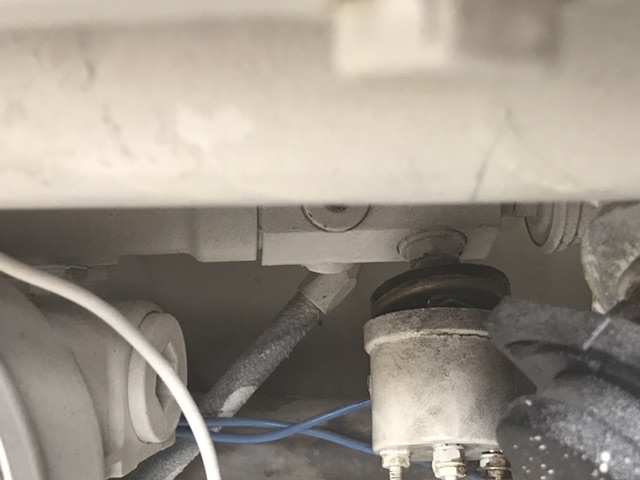

    Thought I had found the problem. See picture attached of oil pressure sender, but confirmed that ER gauge is mechanical.

    That picture looks like a low pressure switch and not a pressure sender.

    I'm a bit confused, despite the fact this thread appears to be "closed" in terms of the need. Photo shows me an electrical sensor, and not what I know of as a "mechanical gauge". Shouldn't the "mechanical gauge" be a simple micro-tube feeding pressure to a mechanical gauge? And if in fact that is what is present, wouldn't the presence of debris at the entry point of the micro tube potentially interfere with pressure readings? Also, if there are multiple gauges fed from multiple senders on the same engine, are they all behaving in a similar manner?

    That's a possibility, but the VDO instruments of old MAN mechanical engines work differently.
    There is a sender on the engine, which depending on the pressure changes its electrical resistance.
    According to VDO testing instructions, its resistance should be 10 Ohms with the engine turned off (i.e. no pressure), and should increase to 105 and 152 Ohms respectively for 40 and 60 psi.
    The values shown by the gauge must change accordingly, of course.
    Not the most accurate system on earth, but it works.
    Consequently, the potential issues with debris in the micro tube that you mention do not exist.
    And a single sender can feed more than one gauge.
