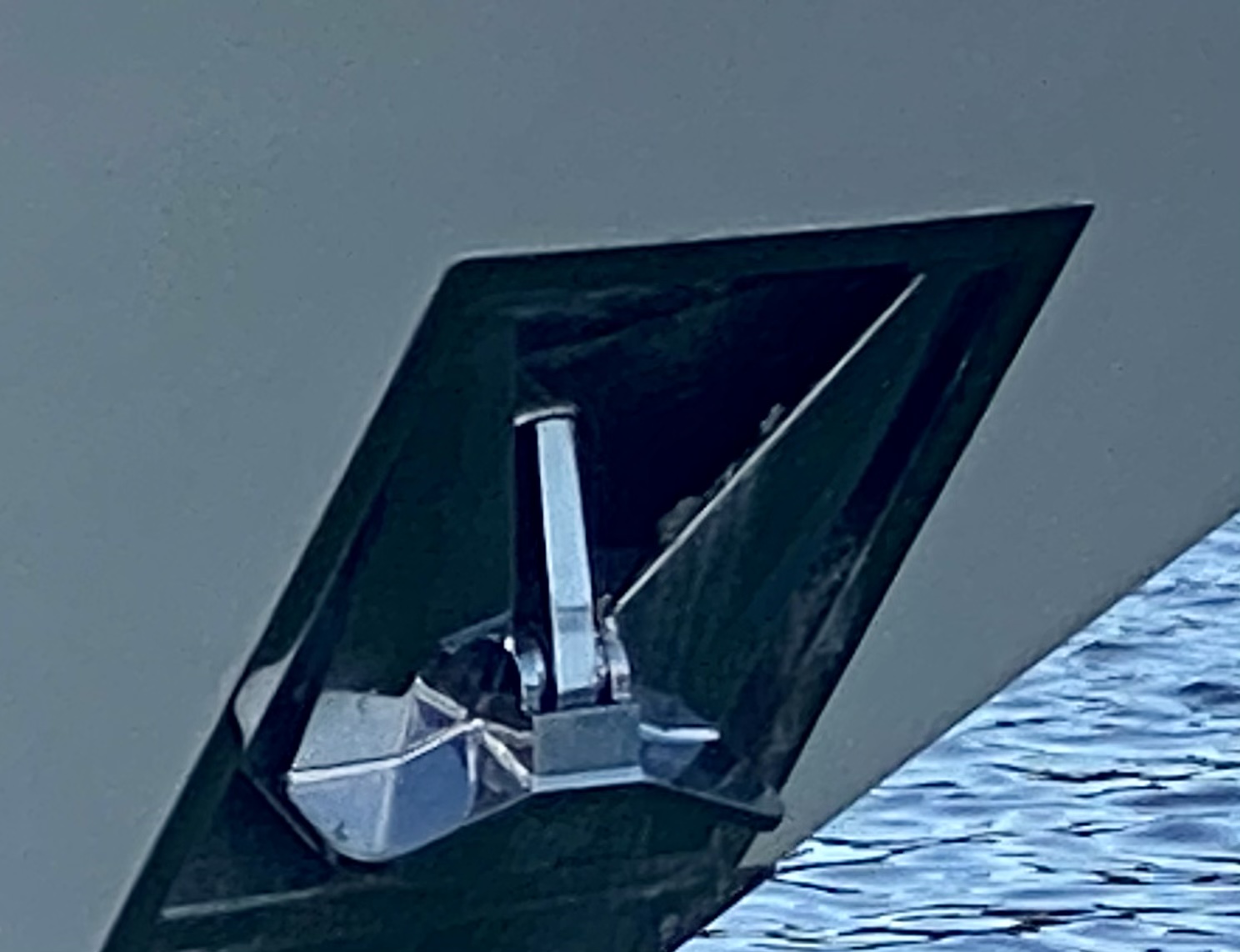

    New to Pool anchors and so far I m not impressed. From the little information I found on line it looks like we have a pair of Pool type N anchors, 90kgs / 198lbs
    So far I ve had to use a lot more scope than I m used to with the Bruce/claw I had in the previous boat. It was a 176 pounder on an 84 skylounge. This thing would hold like Velcro in sand and mud at 6:1. You could feel the bow snap into the breeze when it would set
    with the Pool I ve had to use 10:1 in the same spot/bottom in only 15kts of breeze. 7:1 would result in a slow drag.
    I can’t find any anchor size selection charts on line for these anchors. 198lbs feels a little light for a 110 footer but because of the pocket size I doubt I can upsize
    Am I missing something or do these anchors just require more scope?
    I haven’t anchored in sand yet, just mud. Do they work better in sand ? The Bruce woudl work great in both bottoms

    Must be undersized. I've had the same type anchors on every boat I've run for the past 20 years, and rarely ever drag. In shallow water (Bahamas) I use about 8:1-10:1.
    But in deeper water (50+) I generally use about 4:1
  3. Capt J
    14,638
    You should have closer to 500 lb anchors for your size. Based on a windage situation......Sounds like Lazzara sized them based on weight and not length.

    Yeah, I'd say a bit undersized too.
    For years I worked a 120' Tri-deck with those same anchors, but we were 450 lbs, 5/8" chain.
    The pic you posted looks like it could have been taken from that boat, exact same setup.

  6. Pascal
    8,716
    Thabks for the feed back guys. I d love to upsize one of them but I doubt anything bigger will fit in the pockets.
    i d like to find a selection chart for these anchors but haven’t so far.
    we were out this week end and spent two nights at a spot with poor holding (thin layer of sand over limestone). We held fine in 15kts+ but with 12:1 scope relying on chain weight. We ll see how it works out in the Bahamas, I guess they ll do better in sand
    Another question related to this set up. How do you attach a bridle besides using the tender ? Any trick? Dangling a flat chain hook with a line on each side of the bow to catch the chain?

    not happy with the 200 lbs Poole anchors that are on the 110’ Lazzara i ve been for the last 6 months. We didnt anchor much in Miami but now in the Exumas we anchor 90% of the times. The 200 pounders just don’t cut it as they require twice the scope I used to need with the Bruce’s I ve used in the past in the same locations. No big deal empty anchorages but a problem in more busy spots. Right now off Mc Duffs at Normans, I have 150’ in 12’ of water and we ve slid about 50’ overnight in just 12/14 kts winds
    I m reluctant to use both because of the risk of getting them tangled up on a wind or current shift.
    the pockets the anchors rest in do not allow for any significantly large anchors so ink trying to come up with an alternative.
    one would be to weld a chunk of stainless steel on the base of the anchor to increase the weight although that will not increase the flukes holding power
    second option would be to attach a stainless steel plate around the existing anchor pocket, like a reverse U for the larger flukes to rest against. Pretty simple but my concern is that waves will pound against the forward facing side of the anchor. Or am I over thinking this possibility ?
    finally using a kellet when more scope isn’t an alternative. Problem with that, besides the extra work, is that it would have to be attached and removed to/from the chain with the tender since we can’t reach the chain from deck.
    any suggestion welcome...

    I definitely preferred the pocket anchors arrangement that I used to have in my previous boat to the bow roller that I have in the current one.
    BUT, pockets do restrict your anchor choices a bit...
    That said, I never had a problem with my old stockless anchors - 100 lbs each, on a 35 tons 53 footer.
    Oh, and galvanized, of course. I wouldn't want a polished steel anchor if they were given away FoC.
    On any sandy bottom, 14 kts of wind would have never dragged the anchor by one inch even with an 8:1 ratio, let alone with the 12+ that you mention.
    You could try to see what's the largest galvanized stockless anchor that fits your pockets.
    More than likely, you would also be left with some cash after selling those Pool hooks on eBay.
    Then again, it also depends on whether your boss rates forms over function.
    If there's a contest that galvanized stockless anchors will never win, it's a beauty one!

    Few things
    Have you swam down and eyed it in person. How deep is it digging in or is it skipping.
    Anchor holds by digging in the flukes, they need more surface area. Add material on shank side of flukes.
    The bottom of anchor has that perpendicular foot. That's a problem in my eyes, it's preventing proper embedment. When anchor is trying to set its perpendicular to the direction of pull and forces it to skip instead of dig. Navy anchors are very similar minus the flat foot. Cutting torch would fix it.

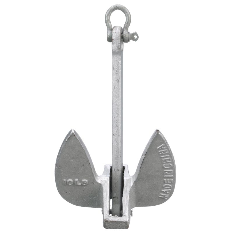

    This was my thought.

    Oh come on it's perfect and only 10 lbs! Made in china!!
    I was using it as an example. No flat foot on the anchor vs his with a foot.
    Obviously will take guts to bring a welder or torch near his beautiful anchor but......
