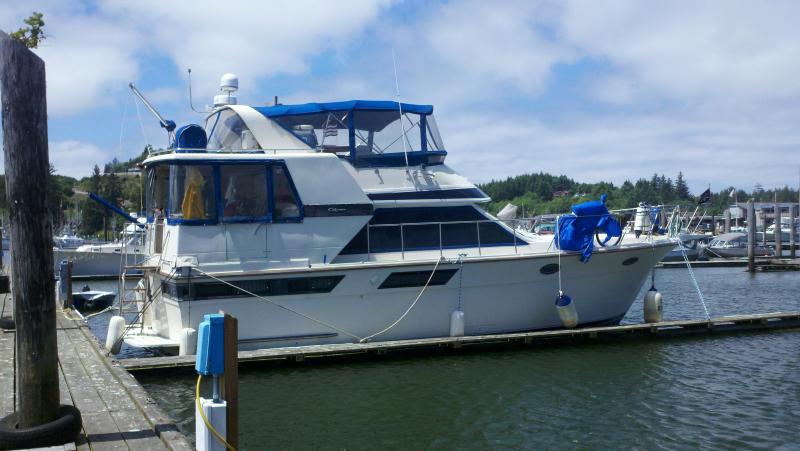

    Hey folks, back with another question. :) I am wondering what you all use as kind of a go / no go range of parameters up here in the PNW waters ? I am looking at heading up to Port Angeles WA From Astoria Oregon sometime around the first week of Aug. I Have a 1978 42' Californian aft cabin that I brought up from San Francisco 2 yrs ago. We have been just floating around here in the Columbia River and to be honest I don't recall what we used to decide to make the hops up.
    I am looking to make it as comfortable a ride as I can but at the same time I need / want to get up to Pt. Ang. sooner than later. So I would like to know what wind speeds / wind wave heights / sea swells and time between them etc. ya might use as kind of a rule of thumb ? I intend to make this trip in 3 hops, Astoria to Grays Harbor, than La Push , than Neah Bay and than on to PT. Angeles so they will all only be a 6/7 hr to 9/10 hr run of 60 to 80 miles. OK well any advise or thoughts are much appreciated by both myself and the "Admiral"

    You have a lot of windage and a high CG. So the weather acceptable to a good blue water vessel may prove a bit challenging for your vessel. Why so many stops? If you get a good weather window just go for it 24/7. Another point to ponder, for a few hundred dollars a day you can get a very good captain to lay things out for you.
