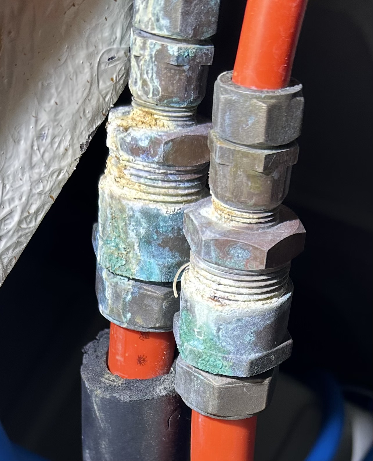

    Yes, you are right. One of the lines says "Kitec" on it, although a vendor told us that Offshore had installed KaiTai in the past...And it's the fact that the fittings are corroded and failing. Pipes are orange and blue and the fittings are corroding.

    Can you post a picture of these fittings?
  8. Barbara Pack
    Barbara Pack New Member
    Feb 2, 2024
    5
    Roche Harbor, WA.
    Here's a try...I'm not so good at the "upload" thing...sorry for my lack of tech.
  9. Capt Ralph
    13,719
    Compression / union-coupler.
    May just need disassembly, cleaning and reassembly.
    If that is 12mm tubing, C-Tec tube union-coupler may be a better replacement.
    If real 1/2" tubing and potable water, then a SharkBite tube coupler.
    That was perfect.

  11. Capt Ralph
    13,719
    I do have to comment;
    Never kick a sleeping dawg.
    In your picture, it looks dry. That same gook you see on it may have well stopped the leak itself.
    Going after this could just open a Pandora's Box.
    Remember, It's a boat. Murphy and his family lives in the bilges.
